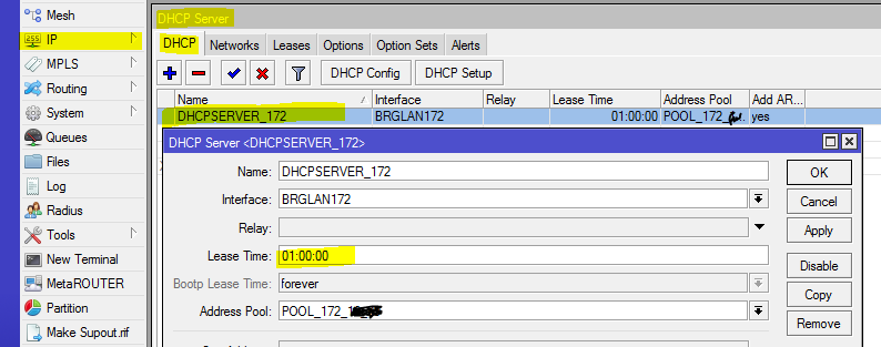

I have a problem while connected wirelessly to "RB2011UiAS-2HnD"Router
  • If I am connected wirelessly to the RB2011UiAS-2HnD router, I faced the problem.
  • I have been using TP-Link Modem/Router in the “bridge mode” as a transparent modem. ( I.e. I reset the TP-Link Mdoem/Router to be in ‘bridge mode’ and then connected the DSL cable to TP-Link, and then I used a two-head Ethernet cable to be connected from one of its ends to the Eth 1 port on the RB2011UiAS-2HnD router, and the other end to be the one LAN ports of TP-link Modem/Router). Then, I setup the RB2011UiAS-2HnD router via PPPoE using Winbox V6.18
    - If I am connected directly to the TP-Link Modem/Router without using the RB2011UiAS-2HnD router , then there is no a problem while connecting Wirelessly.
  • I have Windows 10 Home 64-bit.
  • I have now Windows 10 Home 64-bit installed, even though this problem happens with windows 7.
  • I have HP Pavilion Dv6 laptop
  • I have Wireless Network adapter - Broadcom 802.11n Network Adapter
  • I have LAN adapter (Ethernet) - Realtek PCIe GBE Family Controller
- I have No problem while connected to Ethernet port with Ethernet cable. I only have a problem while connected Wirelessly.
  • Windows 10 recognized all Broadcom 802.11n Network Adapter and Realtek PCIe GBE Family Controller once the installation was completed. I.e, I have NOT installed any drivers for Broadcom 802.11n Network Adapter and Realtek PCIe GBE Family Controller downloaded from the manufacturer website.
  • While connected wirelessly to RB2011UiAS=2HnD router , then after each two minutes there is no internet access occurring, and then a yellow mark shown in front the WiFi icon of Laptop, and I get disconnected automatically from the WiFi network. This happens continually about after each two minutes. I am connected to Home network via this router:
SSID: MikroTik-BCE3DB
Protocol: 802.11n
Security type: WPA-Personal
IPv4 address: 192.168.88.254
IPv4 DNS Servers: 192.168.88.1
Manufacturer: Broadcom
Description: Broadcom 802.11n Network Adapter
Driver version: 6.30.223.256
Physical address: ‎E0-2A-82-F9-33-D9.
Details:
Once the internet access gets lost, then there is a yellow mark shown in the WiFi icon(screen shot below). After that, the connection to WiFi network gets disconnected automatically. However, if I have chosen ‘connect automatically to Wireless Network’’ while connecting to Wireless router in the first time, then I became automatically connected after half a minute since the first disconnection.(disconnection… then connection, and so on).

My questions are:
1- Even if the internet got lost(no internet access- yellow mark in front the WiFi icon), why am then I disconnected? What lets Wireless connection be disconnected???.

Sounds like you have a DHCP issue. Check the DHCP server settings and make sure the clients can get an IP.
Thanks a lot,
NOTE: The problem is once the internet access got lost, then there is a yellow mark in foront the the WiFi icon, and then get disconnected, and then get connected again, and so on. This happens each minute.
What you meant with DHCP settings. Do you mean with this

For export you need to open terminal window and write the export command there. You can get everytime hint what commands or parameters are available by hitting the tab key.
Your problem might be solved by extending the dhcp lease time period to let say 3 days instead 10 minutes.

3- Could you please be a little more detailed how to extend the dhcp lease time period to let it as you say 3 days instead 10 minutes?

It is easy as reading manual.
Use Winbox to connect to yor device and then
