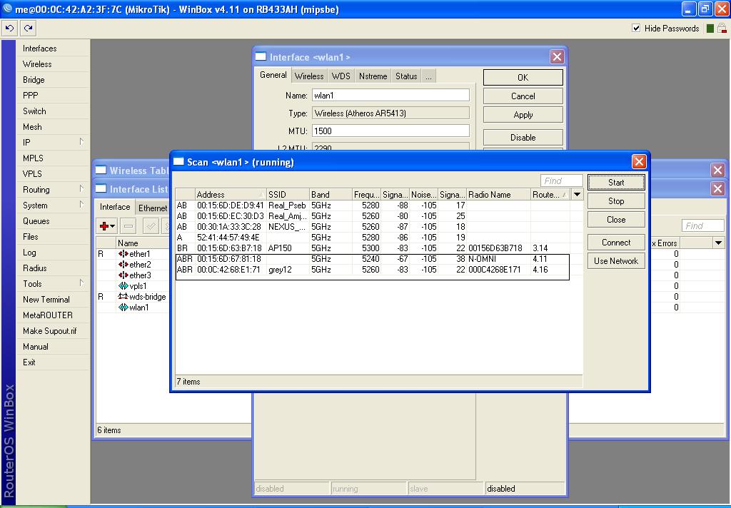

I am trying to connect my Station with the Bridge my signal quality is as under
I am trying to connect grey12 Bridger but I cannot get registration
Waiting for reply

the signal is very weak that’s why you cannot connect.
use “interface wireless print” and copy paste to here..
we should able to know what happening..
