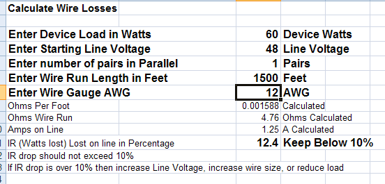

As seen below, the power budget with a single pair of 12 AWG wire is slightly over the recommended 10% loss however the actual draw will be under the rated 12 watt/radio and the devices are not all at the end of the cable. If these considerations were included I am pretty sure the budget would be within of the recommended range.
Also, the PoE passthrough on the Nanostation will will not be able to pass the required load so the power will have to be run around the device not through it. I would highly recommend running a separate carrier lines for the power regardless of going 24v or 48v. With the use an outdoor junction box you can split the power as well as terminate the ethernet and have a pretty clean configuration.

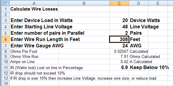

It works on paper based on a draw of 8watts for the radio and 2 watts for the converter I would expect 10w total per NSM2 with 2 NSM2’s per cable. (I don’t know that this is the power budget, it is my best guess). See attached calculation for cable 3 which has the longest reach.
Note that I am assuming that your injecting 48v of power into each cable. I didn’t not sum the total of each cable, I considered them separate in terms of power injection. Furthermore I have never looked into AC power over ethernet… All of the PoE that I am aware of has been DC over ethernet. You should confirm that power being AC won’t interfere with the signal in a way that DC doesn’t. Also with having a combined cable length of under 100M you may be able to chain the radios using the PoE pass-through. You may want to get a power injector that can inject somewhere between 26v & 30V at the start which will drop a bit in transmission. Also Check the operating range of the radio, I believe 30V is the top of the operating range.
