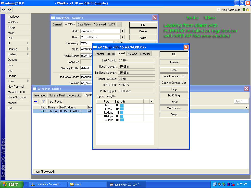

I have seen stable 10 km links in 5mhz channels ! Something I simply can’t do at the same location with a pair of XR9’s.

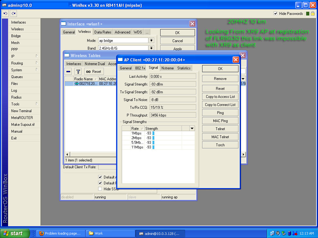

The same thing is true for 20mhz, I have established long and stable links with the FLR9G30 at distances where the XR9 just would not associate.

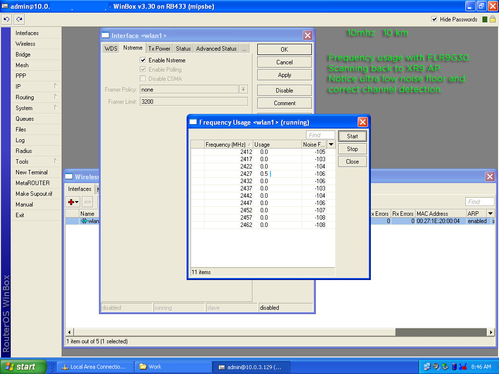

The noise floor on this card is phenomenal I have been doing tests all over my network where I have MOTO gear deployed by a municipal funded giant.
Where the noise floor in the XR9 show in the -70s -80s when I snap in the FLR9G30 I see -105 to -110 !

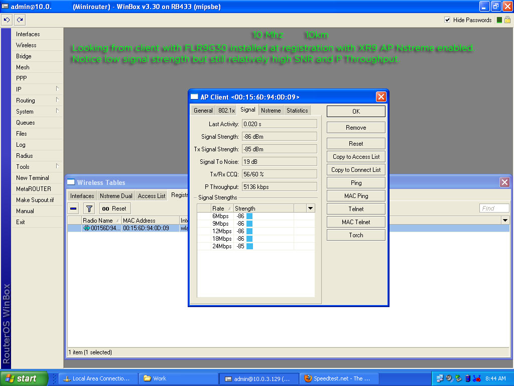

The SNR goes from being -14 with the XR9 to -58 with the FLR9G30.

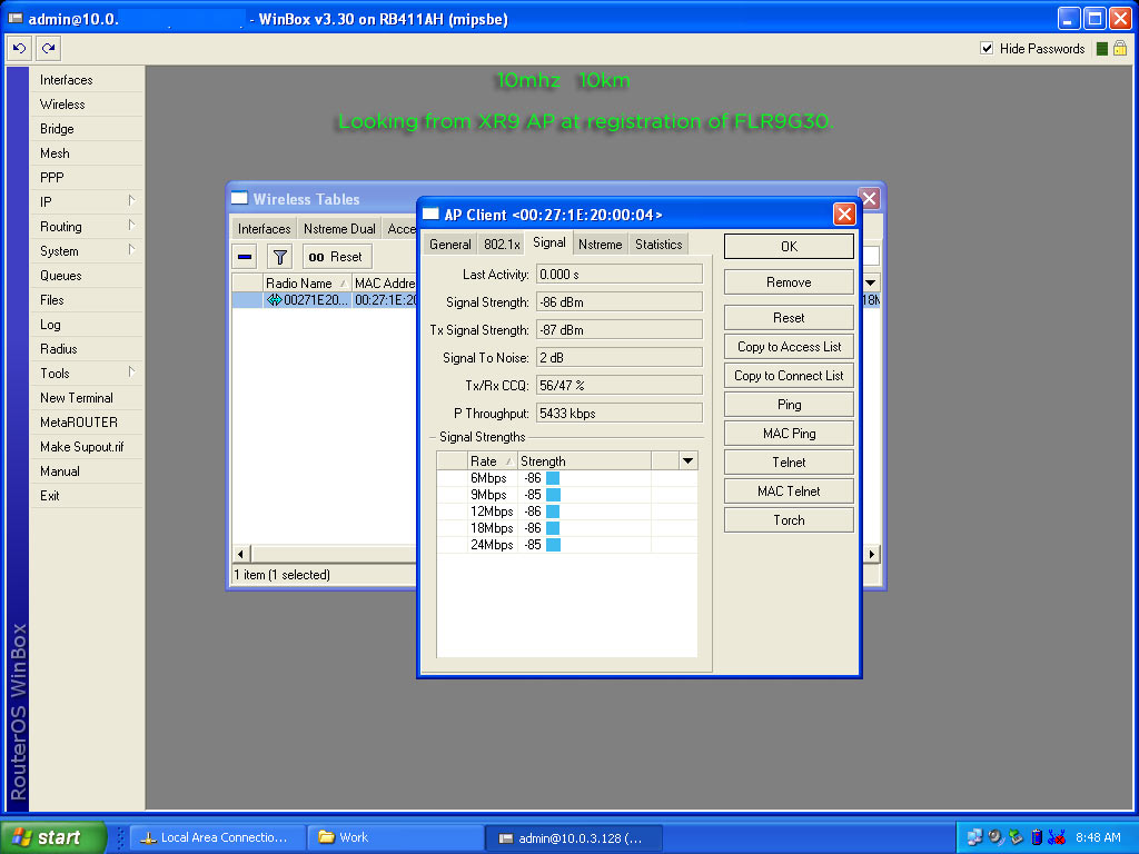

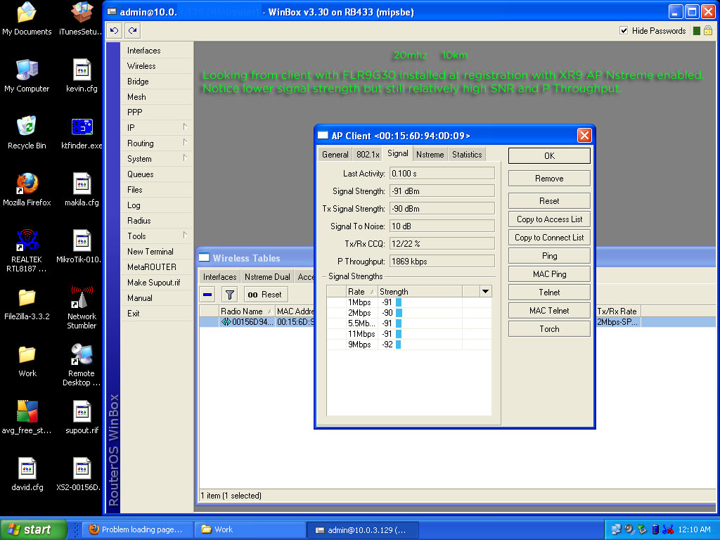

i wont believe it until you post some screenshots of your claims. those snapshops over at dslreports look backwards, the 00:15:6D mac is a ubnt mac, and it shows better ? Im confused I guess.
I appreciate you pointing that out to me .
I had named the creen caps so that they where self explantory but the naming isn’t visible in the post.
I’m going to name them in the image itself to clarify.
i wasnt looking at the names, I was looking at the MAC addresses in the AP client window.
Yes but it’s the Mac address of AP XR9 from the FLR930 based client registration table.
or the Registration of the FLR9G30 in the AP-XR9’ Registration Table. It was too difficult to tell.
I have edited the post and corected the screen caps to clarify at dslreports but I’ll post them here as well.
I can only do 3 at a time here so more coming.
More Screen caps.

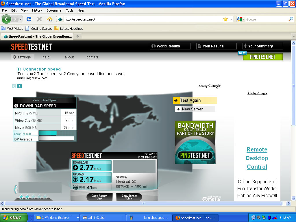

When I was seeing pthroughput at 1800kbit I got a test of 2.77 mbs down and 2.17mbs up
But I will post the correct tests when I get them done to prove it.

Here is the speedtest
This was the FLR9G30 at 10 km and 10 mhz in nstreme.
Pthroughput was reported at 5136 in the client at the time not 1800 as I wrote earlier.
