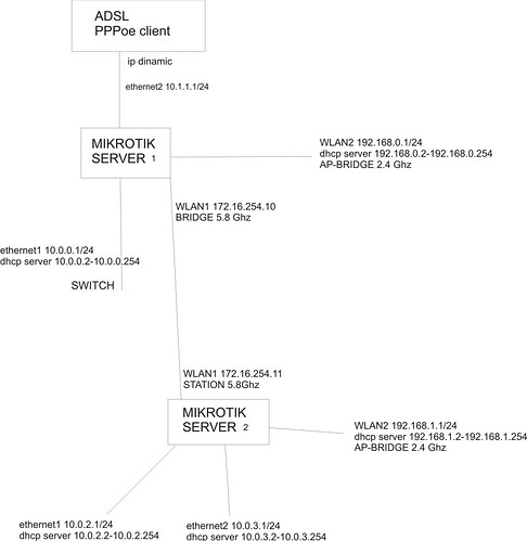

I have internet but i can´t see other pcs
hi, i can ping all interfaces and i have internet in all net but i can´t see other pc and i can´t shared files
This is my configuration...
MIKROTIK SERVER 1
ADDRESS NETWORK BROADCAST INTERFACE
0 ;;; CONEXION A INTERNET
10.1.1.1/24 10.1.1.0 10.1.1.255 ether2
1 ;;; SALIDA INALAMBRICA 2
192.168.0.1/24 192.168.0.0 192.168.0.255 wlan2
2 ;;; SALIDA x CABLE
10.0.0.1/24 10.0.0.0 10.0.0.255 ether1
3 ;;; CONEXION POINT TO POINT
172.16.254.10/24 172.16.254.0 172.16.254.255 wlan1
4 D 190.64.89.254/32 190.132.128.1 0.0.0.0 pppoe-out1
DST-ADDRESS PREF-SRC G GATEWAY DIS INTERFACE
0 AD 0.0.0.0/0 r 190.132.128.1 1 pppoe-out1
1 A S 0.0.0.0/24 r 172.16.254.11 1 wlan1
2 ADC 10.0.0.0/24 10.0.0.1 0 ether1
3 ADC 10.1.1.0/24 10.1.1.1 0 ether2
4 ADC 172.16.254.0/24 172.16.254.10 0 wlan1
5 ADC 190.132.128.1/32 190.64.89.254 0 pppoe-out1
6 ADC 192.168.0.0/24 192.168.0.1 0 wlan2
0 chain=srcnat action=masquerade out-interface=pppoe-out1
1 chain=dstnat action=redirect to-ports=3128 in-interface=ether1 dst-port=80
protocol=tcp
2 chain=dstnat action=redirect to-ports=3128 in-interface=wlan2 dst-port=80
protocol=tcp
3 chain=dstnat action=redirect to-ports=3128 in-interface=wlan1 dst-port=80
protocol=tcp
MIKROTIK SERVER 2
0 10.0.2.1/24 10.0.2.0 10.0.2.255 ether1
1 10.0.3.1/24 10.0.3.0 10.0.3.255 ether2
2 192.168.1.1/24 192.168.1.0 192.168.1.255 wlan2
3 172.16.254.11/24 172.16.254.0 172.16.254.255 wlan1
DST-ADDRESS PREF-SRC G GATEWAY DISTANCE INTERFACE
0 A S 0.0.0.0/0 r 172.16.254.10 1 wlan1
1 ADC 10.0.2.0/24 10.0.2.1 0 ether1
2 ADC 10.0.3.0/24 10.0.3.1 0 ether2
3 A S 172.16.2.208/32 r 172.16.254.10 1 wlan1
4 ADC 172.16.254.0/24 172.16.254.11 0 wlan1
5 ADC 192.168.1.0/24 192.168.1.1 0 wlan2
0 chain=srcnat action=masquerade out-interface=wlan1
Thanks...
Which computers you unable to ping/access with share names ?
I can ping all computer and i have internet in all computer of ethernet1 and wlan2 on mikrotik 1 and ethernet1, ethernet2 and wlan2 on mikrotik 2, but i want to shared files with this computers but i can´t…
You don’t mention what type of file sharing you are using, I assume as you are having problems you’re trying to use Microsoft/Samba Sharing? NFS should work OK.
The net browse feature only works on the same network segment, so you would either need to reconfigure your network to be fully bridged or implement WINS Servers on each segment.
If you’re not bothered about the net browse feature you should be able to create manual shares using the IP address of the target computer, e.g. \192.168.0.10\docs
yes, sorry i trying to use microsoft to share files..
How i can use wins server?
I could be wrong here, but I think if the stations register with a DNS server (A central server on the net) Client based registration, not DHCP. the shares by name would work…
Here is another idea…
Set up a DHCP server (Windows) create a scope for each subnet.
Set up the routers to be dhcp proxys and point them to the Windows DHCP server.
Windows DHCP will update DNS for you…
Share by name will work !!..
"Brousing, I am not sure, but if a wins server is hosted with DHCP, then DHCP will update it and you can send the WINS server addres to the stations. The stations will then register with WINS and then “brousing” should come on line…
