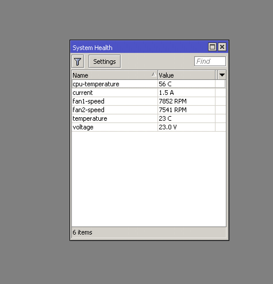

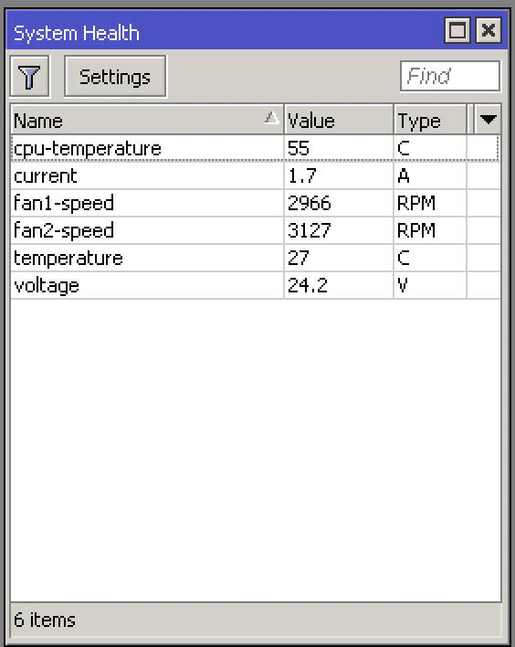

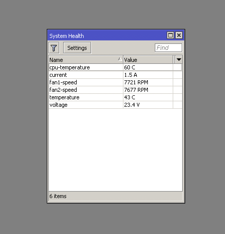

Recently I noticed an issue with users not connecting to a device ccr-1036-8G-2S+
The room temperature is: 26 c
I noticed a high temperature CPU
I opened the device and cleaned it, but to no avail, the same problem
It suddenly changes from 30 to 40 to 25 quickly
What is the problem ?

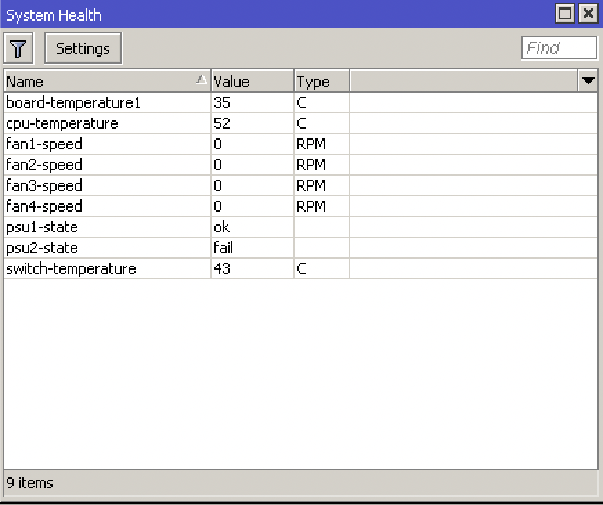

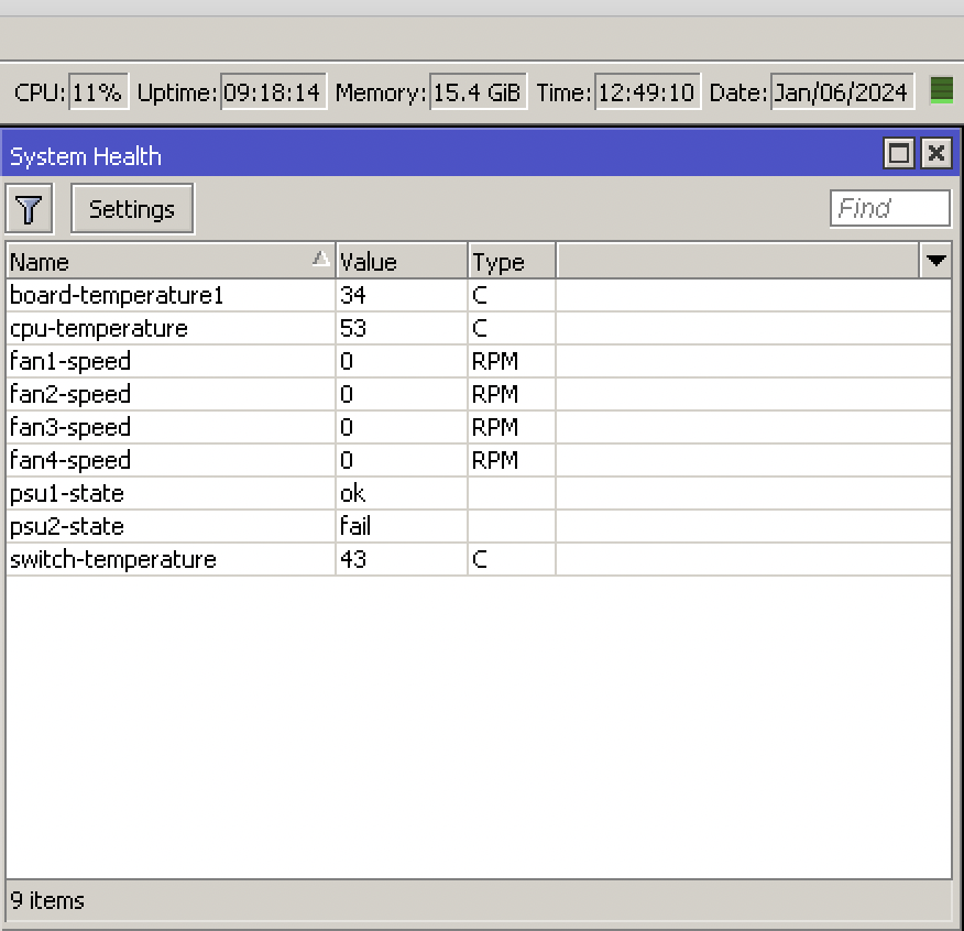

I bought a new device : CCR2116-12G-4S+
and put it in the same room. The results are excellent and the temperature is excellent and constant. Here are pictures of the new device

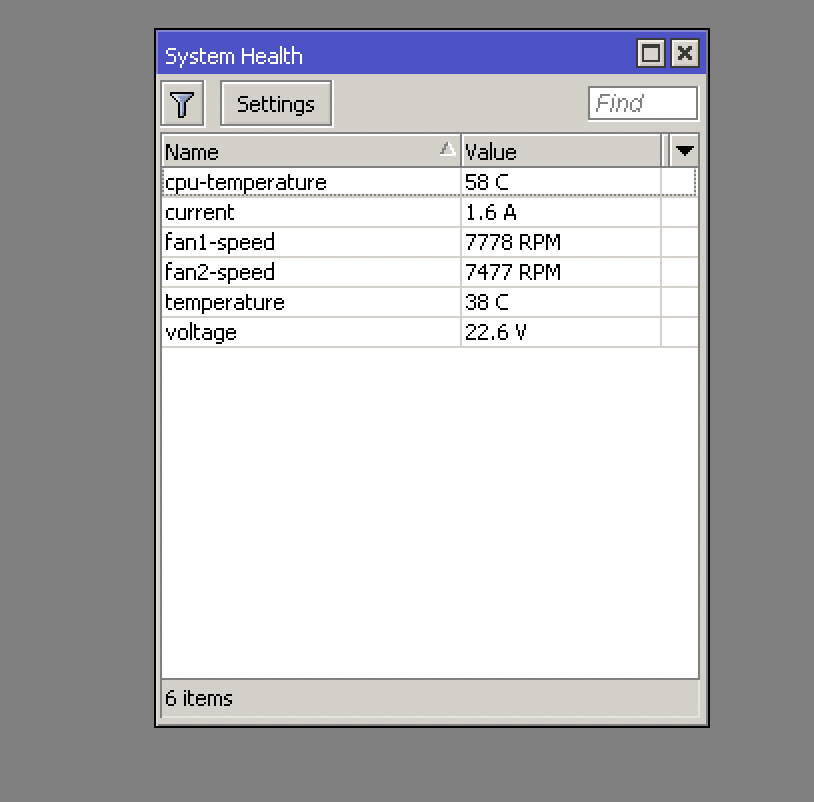

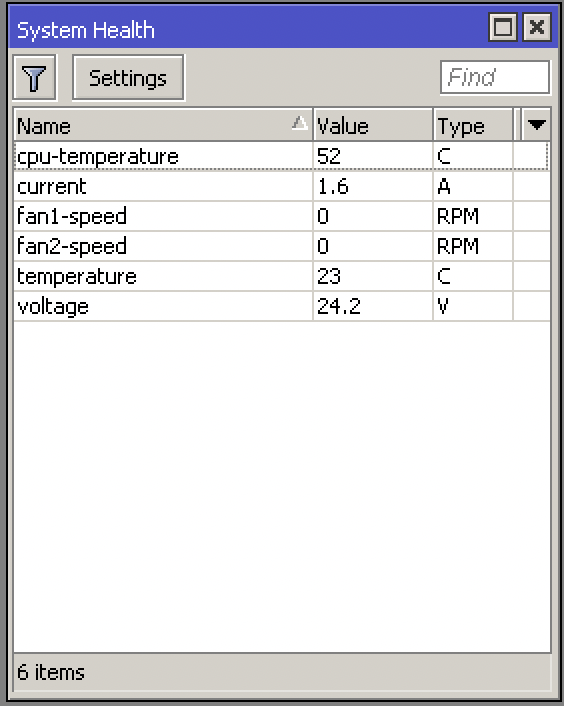

============= The result. ===============
Now the performance of the device is stable, the temperature is constant, and the cooling fan has become less rotating
