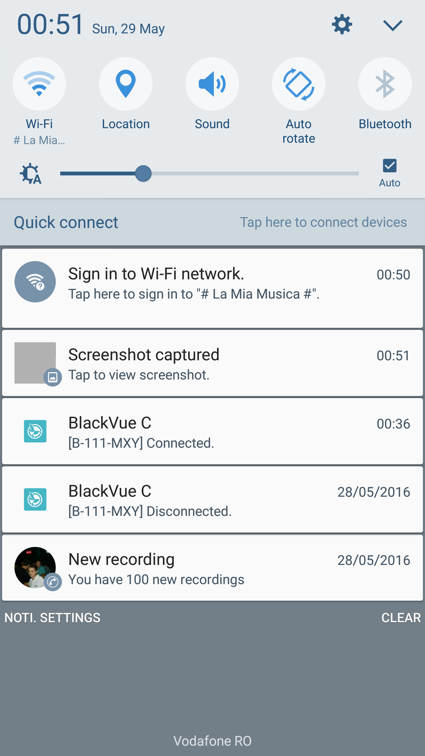

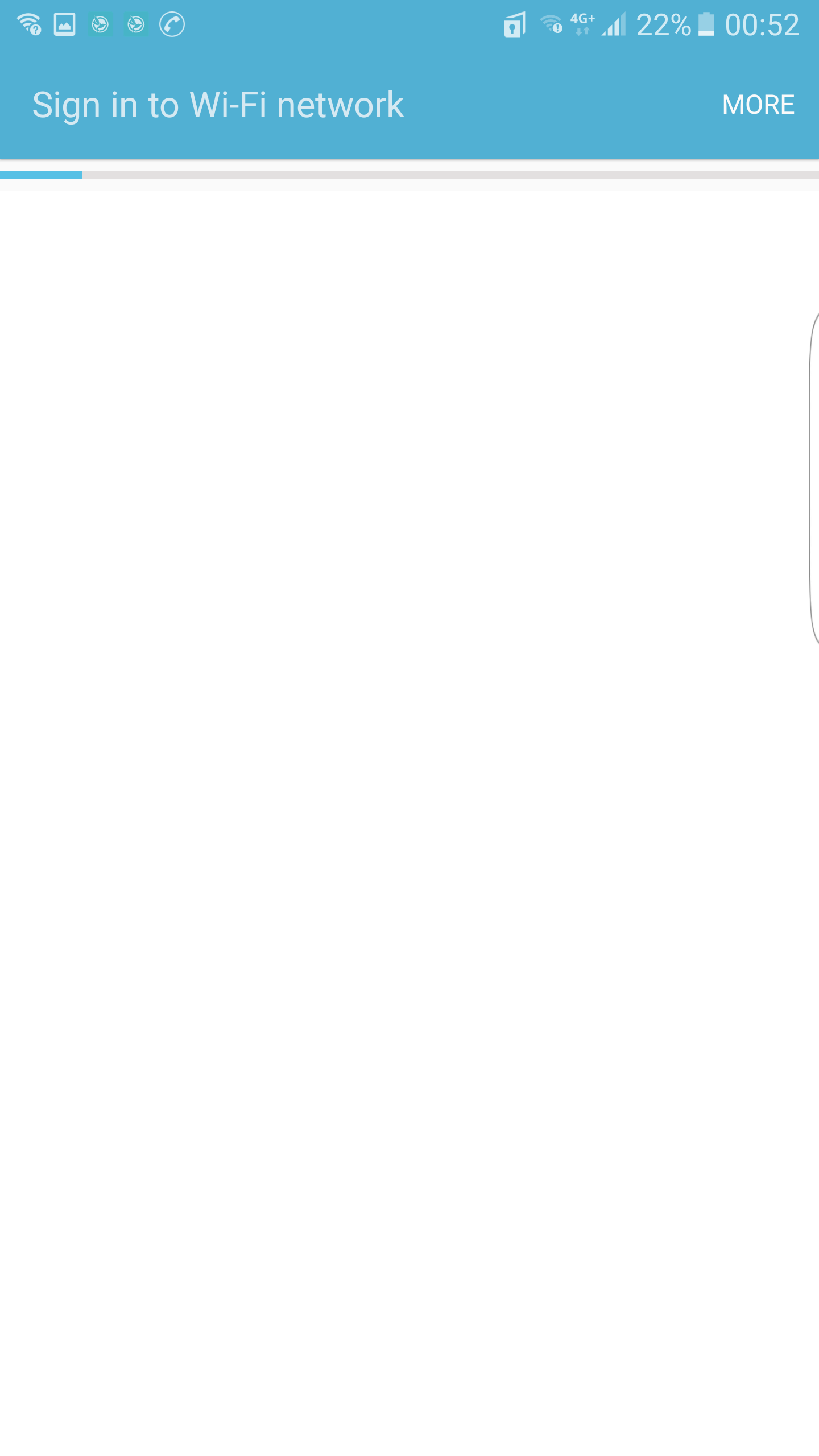

I have many problems there when in the club are about 200 -300 people . Please see the screenshots . The system is freezing and nobody can connect. The splash page don’t show up even i wait 1-2 minute. After that „connection timeout”
This is very annoying and the costumers refuse to connect second time.

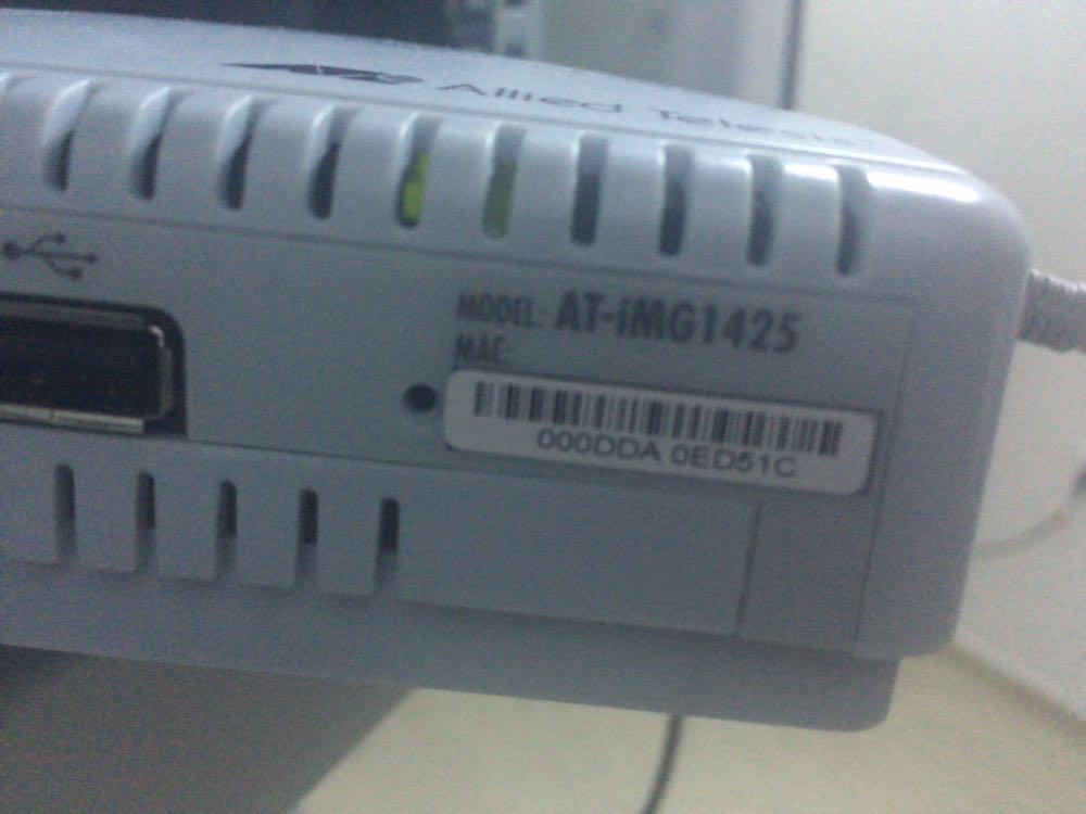

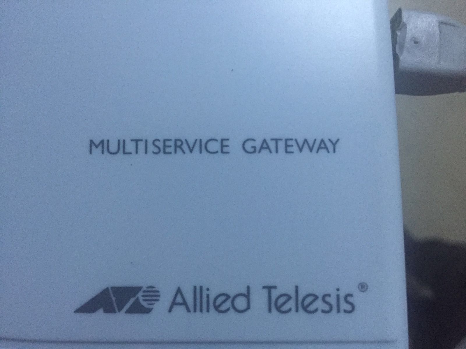

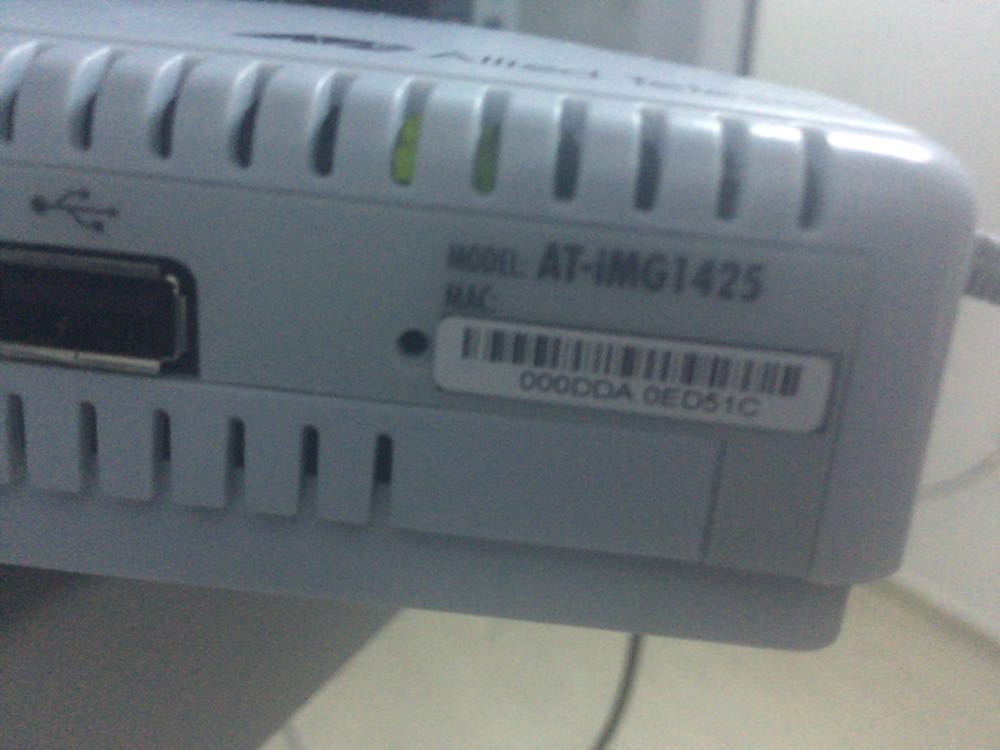

The internet is coming from this device (see pics ) . Maybe this don’t support such many users in the same time?
you should inspect the “/interface wireless registration-table” menu when these users connect. See what their signals are then, not only signal matters, also the other values. Noise will not be reflected in the signal bars.
