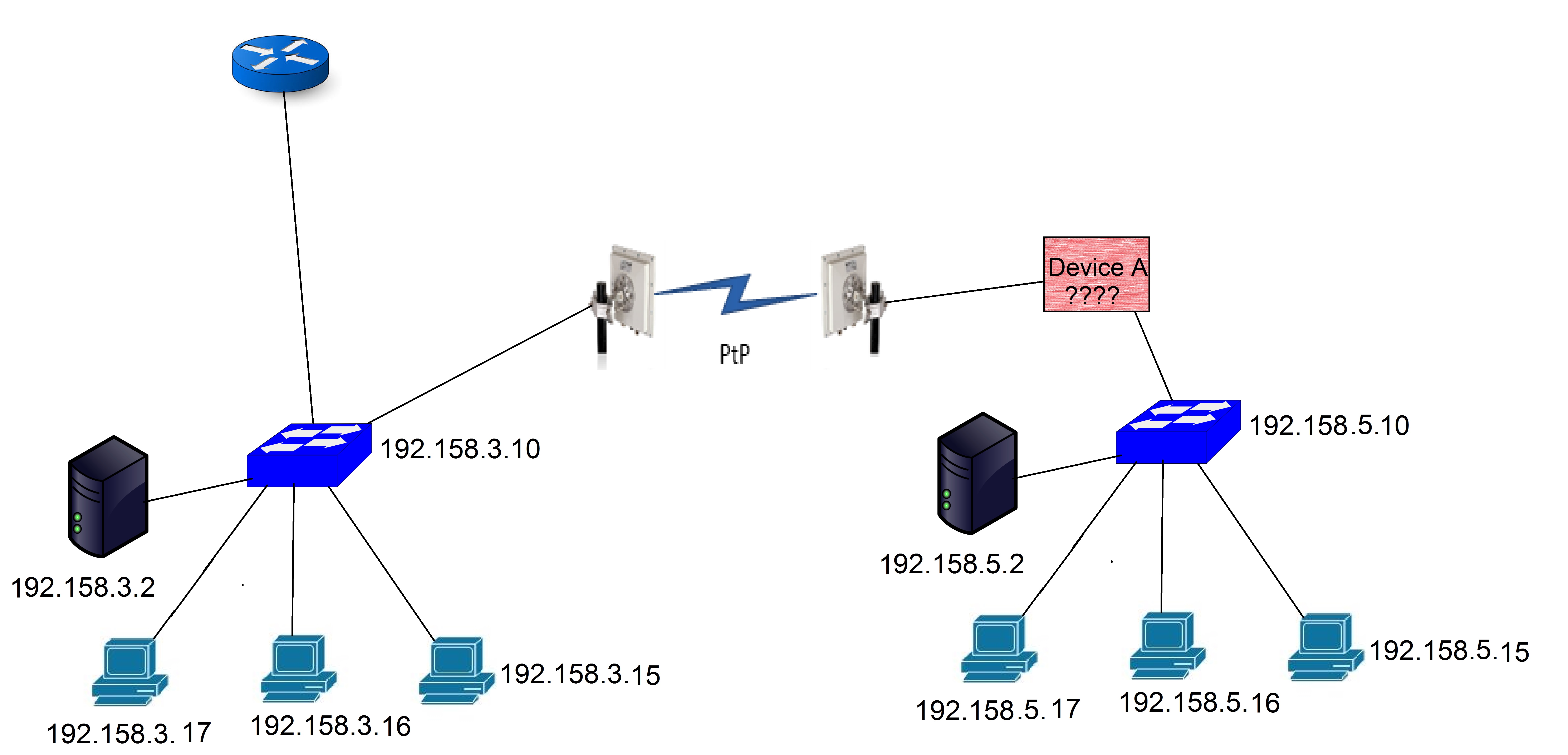

I gonna install attached network but one router remained DeviceA, I need recomendation and configuration to connect two these LANs
please someone help.
thanks
Device A can be a wire and you can attach the second network to a already existing router.
If you insist on the third router, whatever router with enough ports is suitable to your case as you have described it.
thanks for reply
both servers are DHCP server ?
also the router has tow port one is for the network and second for internet.
please let me know How can I solve it while the first network has default gateway according to the router ip?
thnks
Also I think it can be done by only the point 2 point device because it already have routing functions?
please find the attached pictures
thnks
All
Mikrotik devices has Router functions integrated
The only thing we need to now, how much bandwidth you want to route and if this is possible
With the devices CPU
I don’t know what do you mean exactly but maximum speed without bad effect to the device CPU while they are different types.
