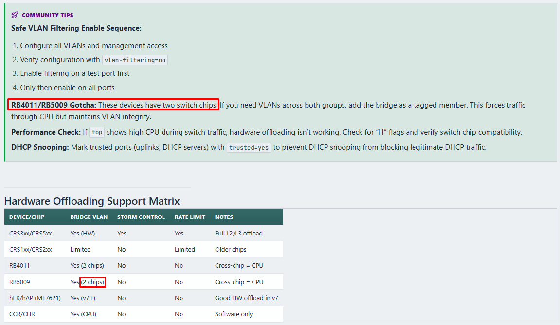

Even with the agentic loop, some hallucinations (or unverified info learned from internet sources, e.g. Community Tips) are still making it through. The example I gave in which book to buy - #15 by Buckeye, while the point of the section was that on a router with two switch chips, and having switch-ports belonging to the same vlan span the two switch chips will result is traffic being forwarded via the CPU is accurate, but the example routers included the RB5009, which is a single switch chip router (you can verify that in the MikroTik RB5009 block diagram here). Then this incorrect information is repeated in
I did a google search for "RB5009 mulitple switch chips" and wasn't able to find any reference to multiple chips in the RB5009, so it seems odd to me that the LLMs would have come up with that idea. But I have seen far worse hallucinations than that.
