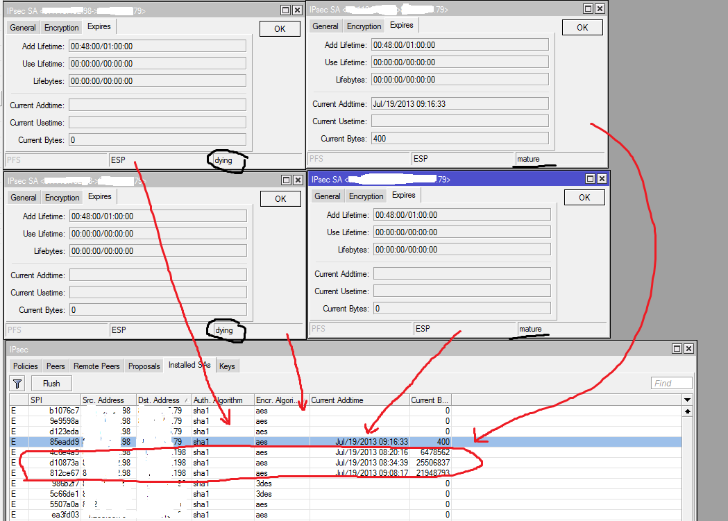

I’ve installed RB2011 with ROS 5.25 at central office .
There are 4 vpn tunnels exist.
Sometime SAs have strange behavior - they do not disappear, and I can’t explain why - see attachment.
As I understood there should only one pair for each tunnel
SRC<->DST /DST<->SRC
but sometimes i have 3 of them for each tunnel :frowning:

SA lifetime comes to an end, ipsec generates new SAs and set them as “mature”. Old ones are set as “dying” which indicates that they will be soon deleted.
well yes, dying means they gonna die , (but when ?) :slight_smile:
Why there are 2 dying and 2 mature for 1 VPN tunnel ?
So, it’s 8 SAs for one tunnel i that OK?

are you sure it is for the same tunnel?

Yes, I pretty much sure that this is the same tunnel.
