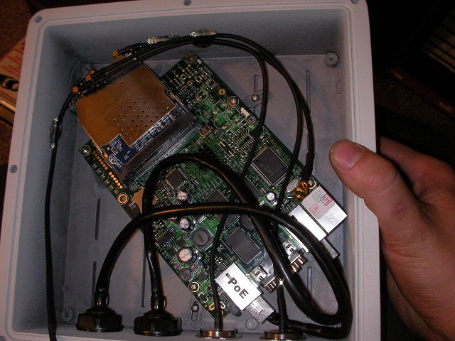

the 433AH can be made to fit into the enclosures, but its extremely tight. i know from experience, as i have stuffed a few of them in there :slight_smile:
alternatively you can use them as just antennas and use a sma to n-female bulkhead pigtail out the bottom of the enclosures and then use an 2 x mmcx → n-female bulkeads on a seperate enclosure and use 2 x CA400 rf jumpers inbetween for dual polarity.
a little more complex but works fine.
Edit: Note RB433 in Arc Enclosure. TIGHT! :slight_smile:
If you use different-length standoffs, you can make some more room for yourself using the Z-axis as well. Don’t ask me how I know… :laughing:
