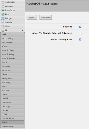

If you use QuickSet, just enable “UPnP”.
If you don’t, find it in this menu:
It looks like it was already activated!
Rules added by UPnP were already visible on your first screenshot. And they all had zero matched packets. Which brings us again to the question, do you have a public address? So far it doesn’t look like there’s one on your router. It’s possible that you have it at ISP’s router and incoming traffic to your router is forwarded using NAT. But that’s not automatic, so it’s also possible that you don’t have any public address for yourself and can’t accept any incoming connections.
