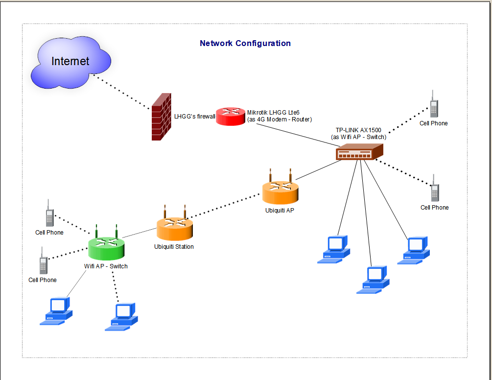

Hi.
I have the following configuration, and I’m unsure about the correct way to set up the MikroTik router. Currently, I have it configured as a modem router, where it handles everything for the network. It assigns IP addresses through its DHCP server and acts as a firewall. I initially set it up this way because I had an older, weaker router. However, since I purchased the AX-1500, which has a triple-core CPU at 1.5GHz and 256MB RAM, I’m considering leaving the routing tasks to this device instead of the MikroTik.
In my current setup, the AX-1500 functions as a Wi-Fi access point and switch. I believe it would be better if I make it the main router instead of the MikroTik. The IP addresses for the entire network are within the same subnet, such as 192.168.1.x. This setup is convenient for accessing the device’s menu from a distance, so I’d like to keep these IPs the same for everything and only change the MikroTik’s IP. I think I should change it to something like 192.168.0.1.
Could you guide me on the changes I need to make to the RouterOS to use the LHGG solely as a 4G modem?
Should I disable DHCP, NAT, Firewall, etc. on the MikroTik and enable them on the AX-1500 router?
What are the correct settings to make this change?
Will I experience better performance after making these changes?

Correct me if I’m wrong - you want to use Mikrotik only as a modem and use the other device as “everything else” (DHCP server, firewall, router, NAT’ting)?
  1. You have to passthrough WAN IP address from Mikrotik to AX-1500. Add another IP addresses for this passing (for example it can be the 192.168.0.1 and 192.168.0.2).
  2. You have to get rid of those mentioned functionalities from Mikrotik and configure them on AX-1500.
    At this point Mikrotik will be like “transparent” and everything will happen on your gateway.
You can also go in another direction:
  1. Move functionalities (without NAT) to AX-1500, get rid of them from Mikrotik.
  2. On AX-1500 add a static route 0.0.0.0/0 pointing out to Mikrotik, leave the same route on Mikrotik pointing out to WAN. Mikrotik will NAT masquerade as it does now.
In my opinion the first proposition is a better solution, but the second is easier to configure and understand.
If you are thinking about network segmentation, adding vlans and configure a VPN connection in the future, I recommend the first option.
I am not able to say anything about network performance after these changes.
EDIT: in the second scenario you should consider leaving firewall (or a part of it) also on Mikrotik. It’s hard to say without knowing your firewall rules

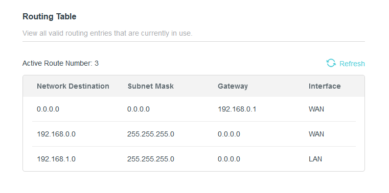

Edit: I changed the Mikrotik ip to static 192.168.0.1 and then I created a route of destination address 0.0.0.0/0 with gateway 192.168.0.1. I also disabled the dhcp server.
Then I changed the AX1500 ip to static 192.168.0.2 and then it created automatically the bellow routes.
I disabled firewall on AX1500 and I have leave it enabled on Mikrotik. I left also enabled the NAT on Mikrotik, and I tried disabled it from the AX1500, but the internet stops responding when I do this. Why is this happening?
After finished the above configurations, I don’t have access on Mikrotik interface anymore, so I have to disconnect it from router’s WAN port and connect it straight to my pc with static ip on pc, in case I want to connect to interface. Is it any way to make it visible again without this process?
What else should I change? Are the above changes correct or have I make any mistakes?
Did you create it only on AX-1500?
To be able to reach Mikrotik and network after disabling NAT on AX-1500 you have to add another route (on Mikrotik) - 192.168.1.0 with gateway 192.168.0.2 (AX-1500 address).

It has created automatically by the AX1500 when I did the rest of the changes.
I will do the change you said at the Mikrotik too.
I will try to connect the MIkrotik straightly with my laptop, at the roof, to check if there is any issue with the long cable finally. When I left only the 1000Mbs setting at the mikrotik’s ethernet settings, I lost the mikrotik and I had to reset it to bring it back, so there is definitely something wrong either with the cable or the mikrotik. I hadn’t realize that it was at 100Mbs from the beginning…
So you did IT on Mikrotik if I understand it corectly. It’s a mistake, it should point out WAN interface or IP address on your ISP router. If the network connection is still working after adding this route (pointing to 192.168.0.1) - you don’t need it at all because you obtain it dynamicly from ISP.

I had changed only the IP of Mikrotik that moment and I disabled the dhcp, so somehow the AX1500 created by itself those route settings.
What I mean is that such a route shouldn’t be present on Mikrotik. If it’s not there, it’s okay.
