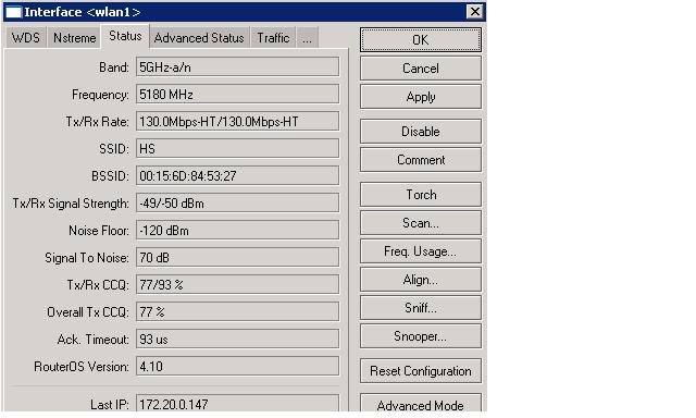

Tower installer certifies all dishes are aligned perfectly now. I am getting -49db-52-db on 7 mile links, but still have the same problem. Band-width test always start at 20+ Mb, and then dwindle down to 4Mb (max) in a 10 seconds or less. The speeds never go back up and ping times run from 400-1000 ms, then drop back down to 1 ms when band-width test is terminated. CCQ is always 85-100% before running tests and link shows it is locked in between (N Wireless only) 117Mb-130Mb. I changed everything from bridged to routing between all interfaces, but that did not change throughput either.

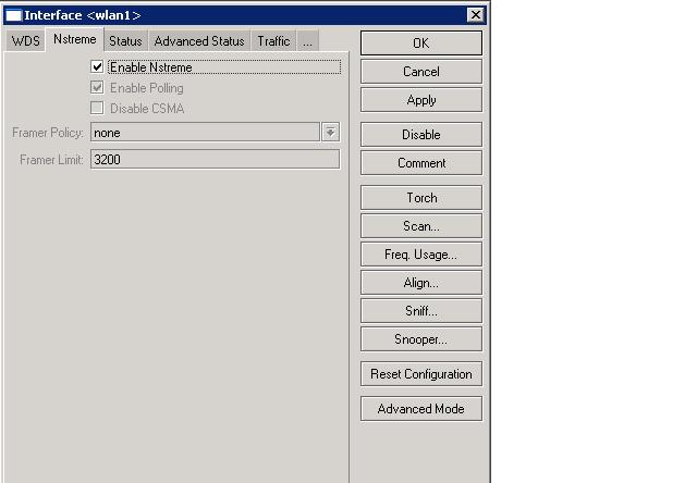

Are you using nstreme?

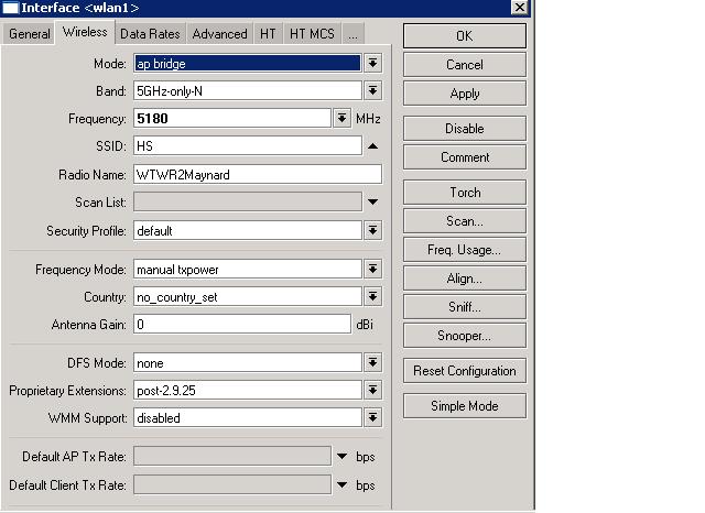

Post screenshots of your config for us to review.
I am not using nstreme.
Let me know if you need more of the configs

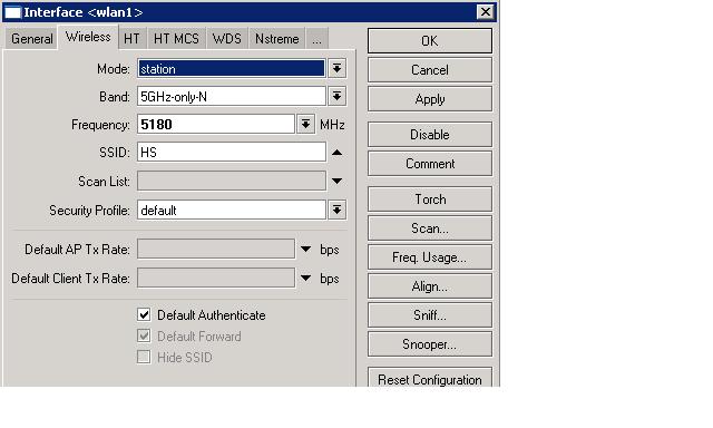

Station config

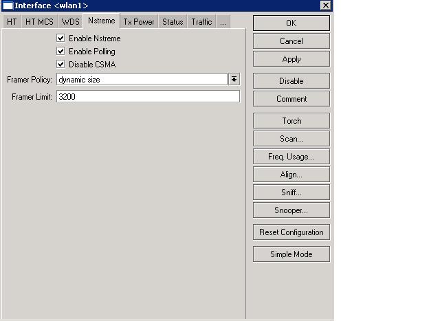

DEFINITELY use nstreme. It makes these kinds of links work right. Turn it on for both sides.
Turn off CSMA and enable Polling. Dynamic or Best Fit framer modes work well.

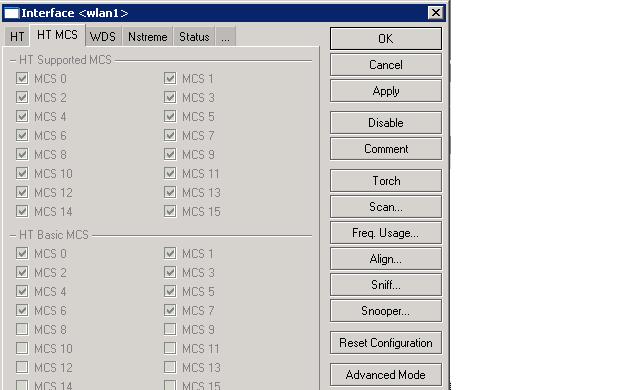

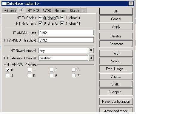

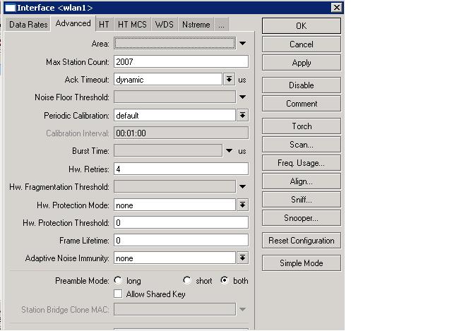

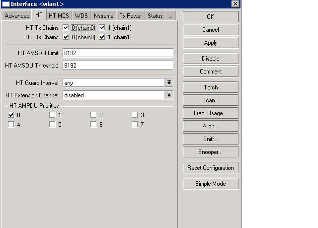

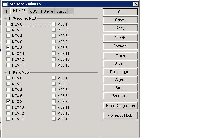

Can I see a shot of your ADVANCED and HT MCS tabs?
Those CCQ’s are looking sick, Maybe try another freq? Are you sure than 5.1-5.3ghz is supported by your dishs?
AP Advanced and HT-MCS Tabs

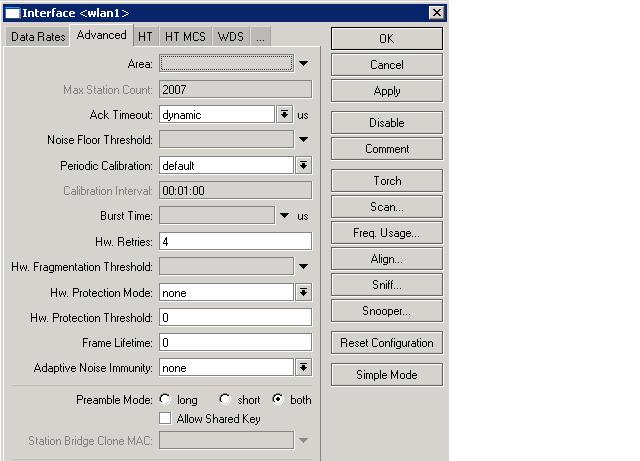

Station Advanced and HT-MCS Tabs
We get the same results no matter what frequency is used
OK, seriously. You need to enable NSTREME as I outlined about and do the following:
  1. Set HW Retries to 15 on both sides
  2. Uncheck set Data rates tab to manual
  3. Uncheck all 802.11a rates (no rates remaining)

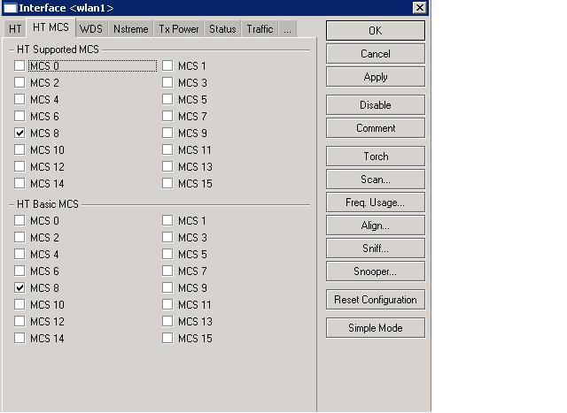

  4. Uncheck all MCS rates except for MCS8
Do the above on both sides of the link.
You should have a solid, high throughput link if you do these things.
If you get a solid link, raise the MCS rates until you are happy with the results. I prefer to lock in my rates to a specific one rather than letting it alternate. You have good enough SNR to do this.
No one is going to be able to help you more until you’ve done these things. Report back and let me know.
I was responding to the other person’s question with my last post.

Turn on Adaptive Noise Immunity and set it to “AP & CLIENT MODE”.

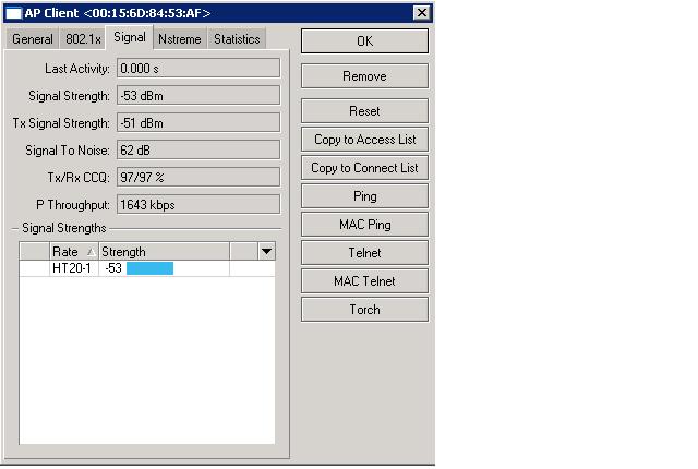

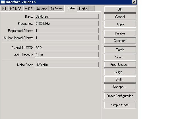

Double-clikc on your wireless interface, go to the registration tab, double click on your connection, go to the signal tab, and give me a screen shot of that. Both client and AP please.

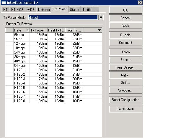

Also, let me see your HT MCS tab (client and AP), nstreme tabs (client and AP), and Tx power tab on the AP side.
Experimented while waiting for a response. Enabled mcs 10 and mcs 12. Had 26 Mb each way. Put it back to mcs8 for now.
Ap config info #1
Ap config #2
Station config #1
Station config #2
OK, 97%/97% is pretty solid for 802.11n. Just do MCS15 on both sides and see what you get.
Do you want to go faster? If so, go to HT tab on each side and enable Extension Channel as “above control.”

I checked mcs 8 - 15 in supported and basic. let me know if that is incorrect.
I changed to “above control” and now have just under 60Mb throughput.
