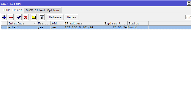

Every time I install a new machine, I need to check the IP address obtained by dhcp
Then execute the command to add 9 new IP addresses
For example, the obtained ip is : 192.168.0.101/24
Then use the following command to add another 9 ip addresses:
:for i from 1 to 9 do { /ip address add address (“192.168.0.”.$i+101) interface ether1}
Is there a way to make the script automate this process

Thank you for your willingness to help me, because each internal network ip address corresponds to a public network ip address, but only the first one can be obtained automatically, and the latter need to be added manually
Ok… understanded.
Leave me some minutes to write the script.
