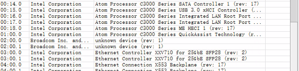

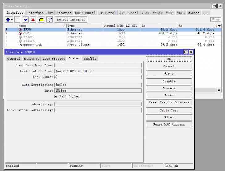

XXV710 SPF0 failed to get link on power up. The interface must be disabled and enabled once.
Auto negotiation is always failed

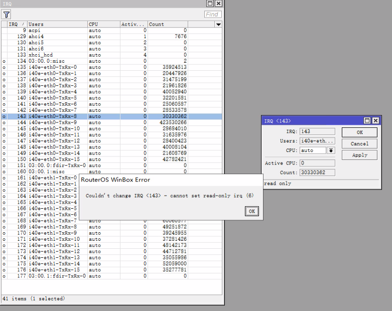

IRQs are read-only and cannot be changed manually. RPS uses a lot of CPU resources
