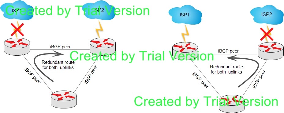

Hi..
Here is simple solutions and use full at same time
Just add one more connection between to cisco routers and create new peer connection between Cisco routers as iBGP..
what will happen when provide that connected to cisco1 goes down.. the learned default from Cisco2 will be activate and use as backup link..
Please see attached pic..
Let me know if all is clear for you dear and its work
Also please see http://mum.mikrotik.com/presentations/AE12/ali.pdf
Best regards
Ali Sami
