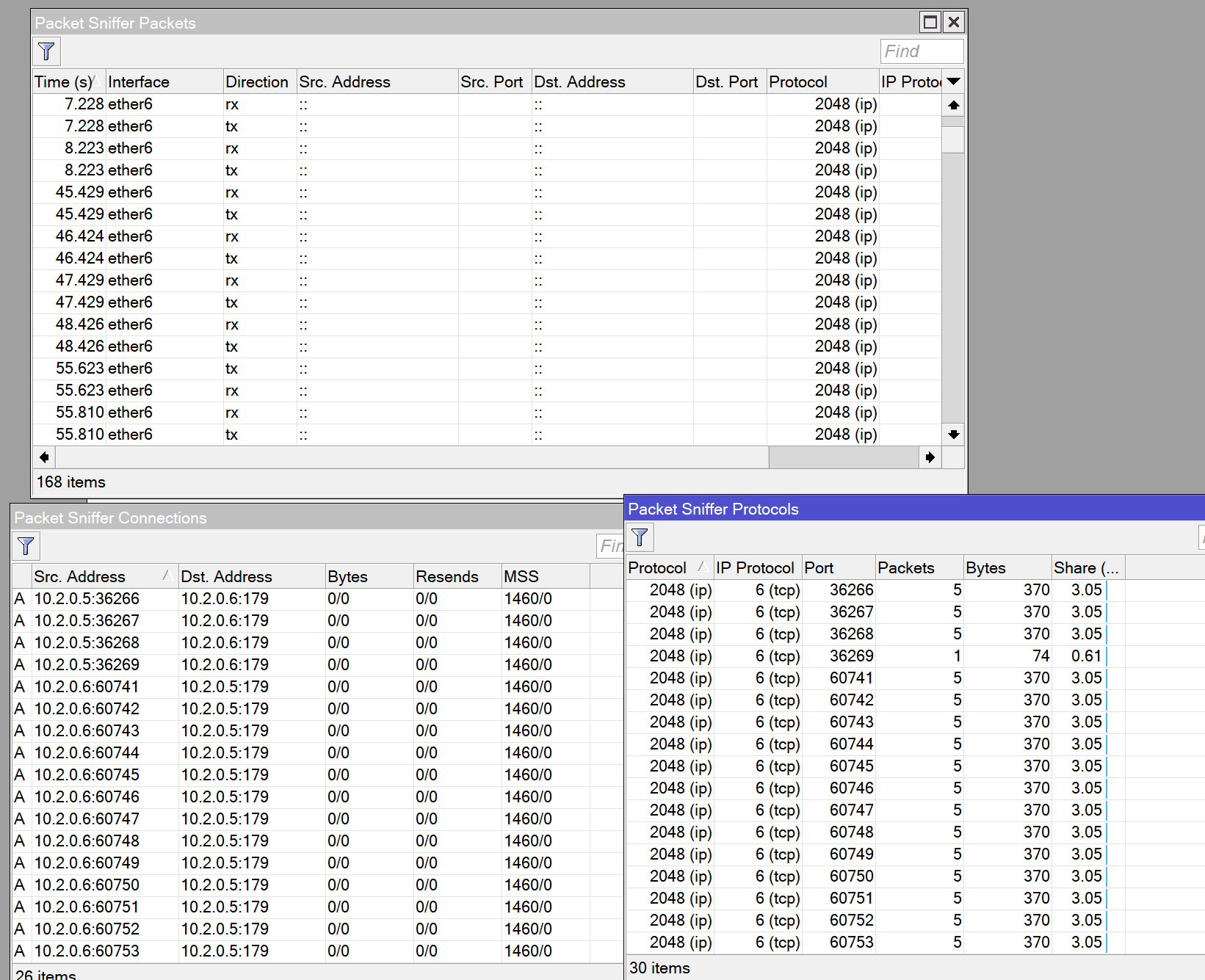

This is what the sniffer is showing on ether 6 for both Routers. Output is specifically from router using 10.2.0.5.
I’ve set update source to ether6, but the issue remains.

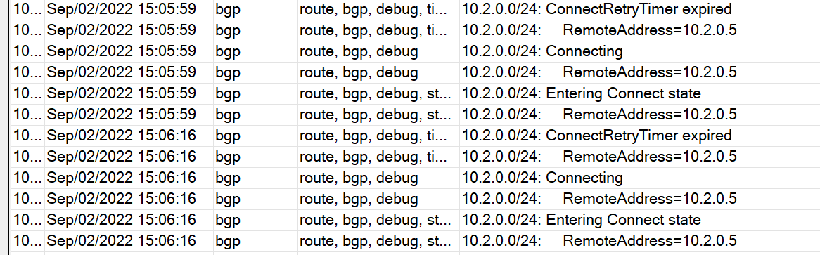

This is from the Router using 10.2.0.6 [BGP Logs]
Well seems like reachability is fine since you can see the connection attempts going in both directions. I assume the two sides can ping each other’s BGP addresses and the ARP tables are fine? And /ip route check shows the interface you expect on both sides?
If you forcibly set multihop=yes on both sides do the peers come up? I can’t see why you’d need to set it in this case. There shouldn’t be a TTL decrement, the far side is in an attached network prefix, and you’re doing iBGP so it should be the default. I just can’t think of anything where the reachability is otherwise fine that would prevent getting further in the BGP FSM than “Connect”. Firewall/nat/mangle rules or multihop is the only thing I can fathom.
Well it is stuck on connect state so three-way handshake is not successful.
