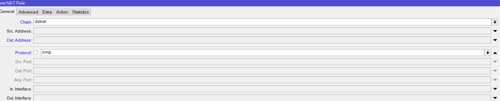

how can do something like dst-nat for ping(icmp) an specific device inside local network

No different than any other NAT except the Protocol is icmp instead of the more common tcp or udp - I ran one for a specific purpose a while back.
when i select dst-nat and icmp for protocol the dst-port will go disabled so then how to specify the incoming icmp
Correct, icmp does not have ports.

You are almost there. Add the In Interface, and on the Action tab, set for DST NAT and tell what IP to send it to.
this is not working!!!
I just set this up on one of my routers. This is working fine. Note that if you don’t have a forward rule to allow anything DST-NATted, you will need to build a specific rule to accept these packets.
Also note that the computer that your forward to must allow icmp packets (newer windows installation do not by default).
