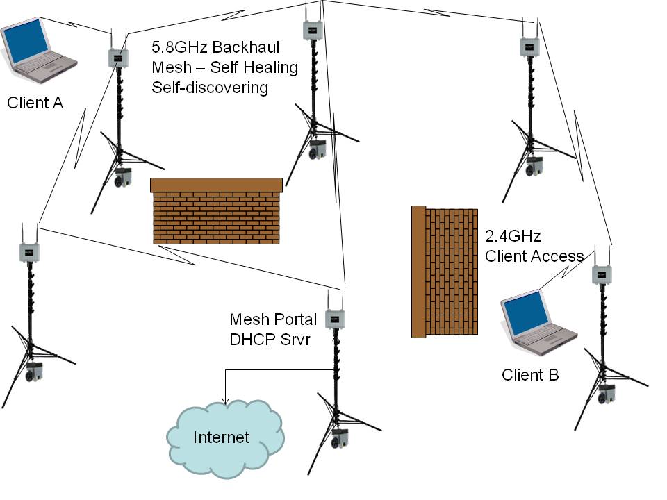

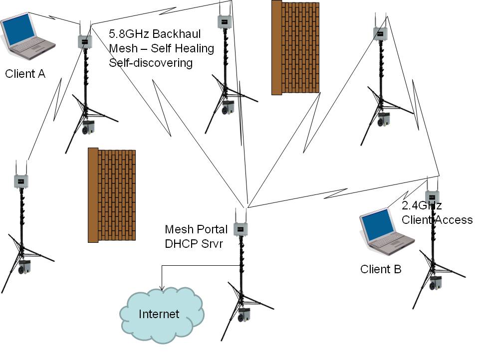

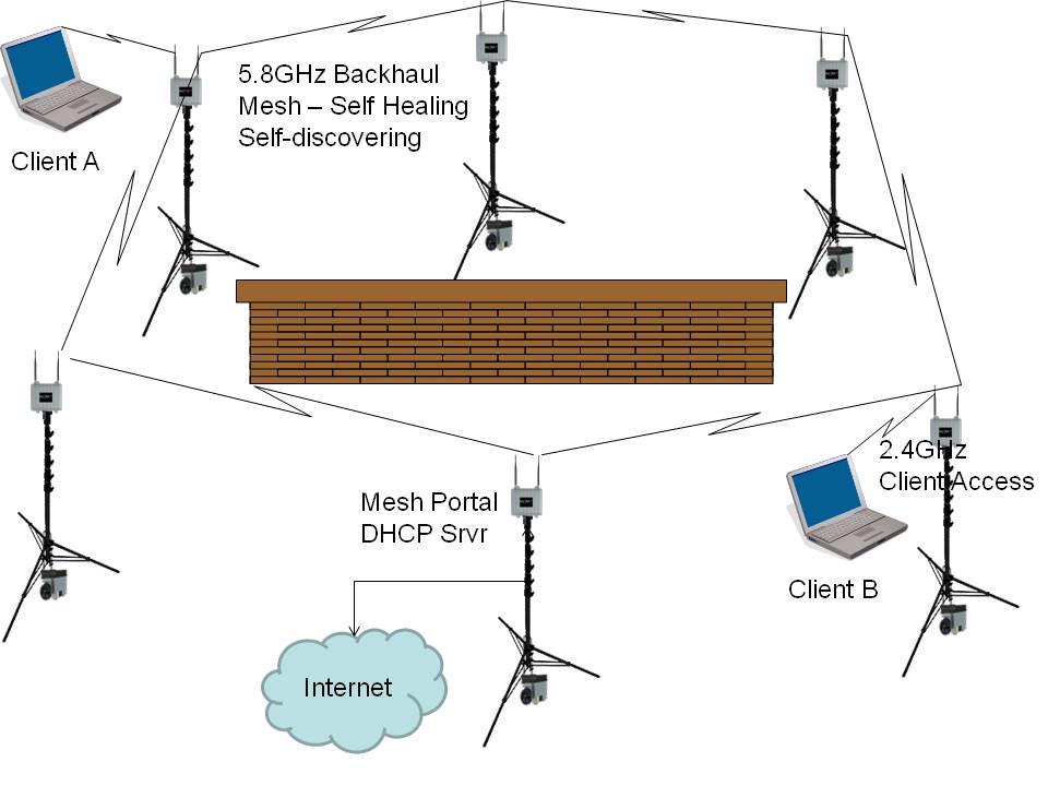

While we would like to set up this mesh using single radio 2.4GHz, the diagrams show dual radio 2.4/5GHz systems, where 5GHz is used for mesh backhaul and 2.4 is for client access.
The mesh needs to be self healing, self configuring. If obstructions move around or links are lost, the paths need to reconfigure and traffic should not be lost.
There would be one mesh portal with Internet access. This would be a NAT server to the mesh. It would be the single DHCP server to the network, including all of the client devices. Clients should be able to communicate across the mesh as well.
