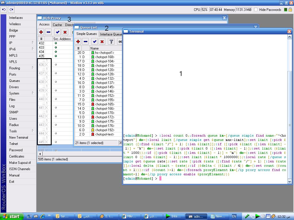

I’m sorry its not working
and thanks :frowning:

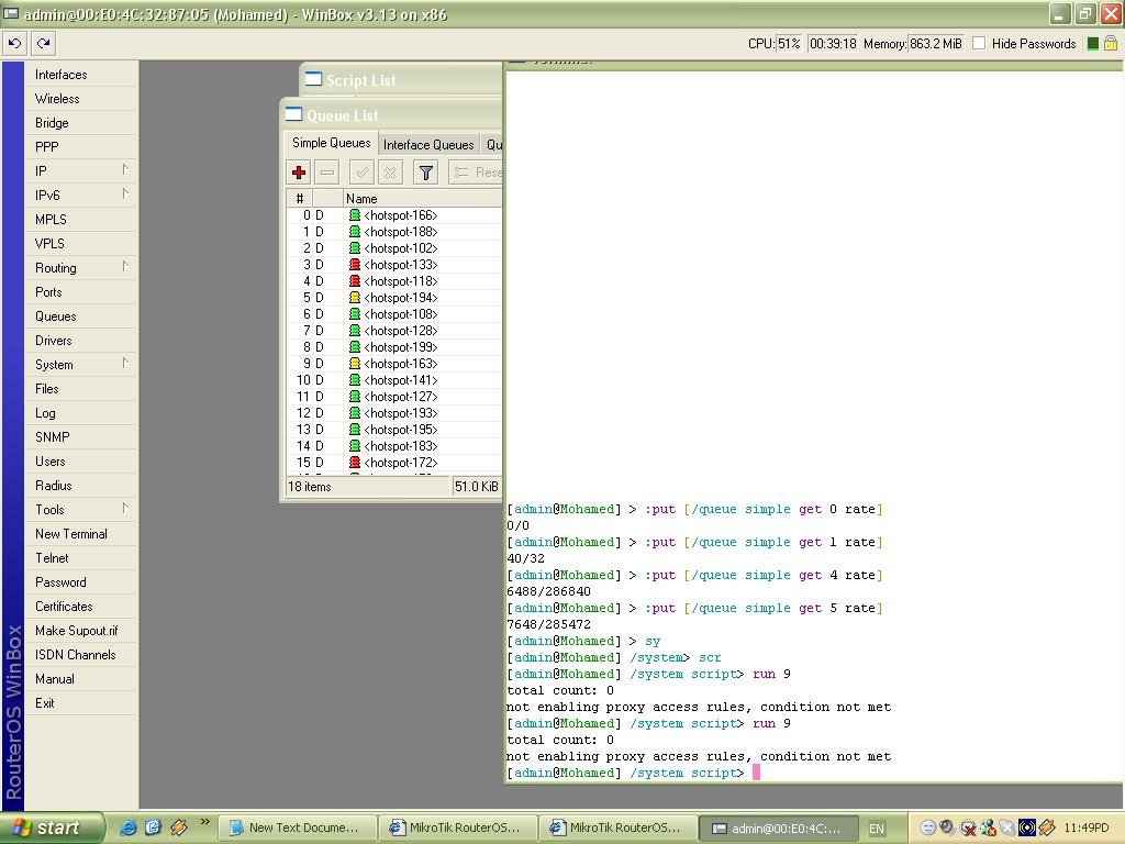

ok
i try to do wat you say and that wat i have
[admin@Mohamed]/system script print
8 name=“ques2” owner=“admin” policy=ftp,reboot,read,write,policy,test,winbox,password,sniff
last-started=oct/08/2009 03:21:05 run-count=5

the condition not met mean = $count >=1 have’nt any client over 75 % ???
if its mean that wen i run thes script i was have 4 client over 75%
and itray it alot of time
:local count 0;:foreach queue in=[/queue simple find name~"^<hotspot"] do={:local limit [/queue simple get $queue max-limit];:set limit [:pick $limit ([:find $limit "/"] + 1) [:len $limit]];:if ([:pick $limit ([:len $limit] - 1)] = "k") do={:set limit [:pick $limit 0 ([:len $limit] - 1)];:set limit ($limit * 1000)};:if ([:pick $limit ([:len $limit] - 1)] = "M") do={:set limit [:pick $limit 0 ([:len $limit] - 1)];:set limit ($limit * 1000)};:local rate [/queue simple get $queue rate];:set rate [:pick $rate ([:find $rate "/"] + 1) [:len $rate]];:local delta ($limit - $rate);:if ($delta < ($limit / 4)) do={:set count ($count + 1); :put "rate: $rate, limit: $limit, increasing count"} else={:put "rate: $rate, limit: $limit, not increasing count"}};:put "total count: $count";:if ($count >=1) do={:put "enabling proxy access rules";:foreach proxyElement in=[/ip proxy access find comment=1] do={/ip proxy access enable $proxyElement;}} else={:put "not enabling proxy access rules, condition not met"}
Try that for debugging purposes
tahts wat i have
The script I posted last should be printing additional debug lines.
im sory mr fewi itray wat would u say its right script but its not wat i need also i need if 4 user make download enable the proxy wich disable the download or disble exe,avi …
:if ([:len [//queue simple %nmber-of-red-colour%]] >=5) do={/ip proxy access enable [/ip proxy access find comment=1]}
wen i tray this
and its not working
iwas have 4 client make downlaod
Unless I’m mistaken, that screenshot does not show you running the script you quote in the same post. The script you’re quoting in the same post outputs one line per Hotspot queue found.
If you are sure you’re running that script, post the output of

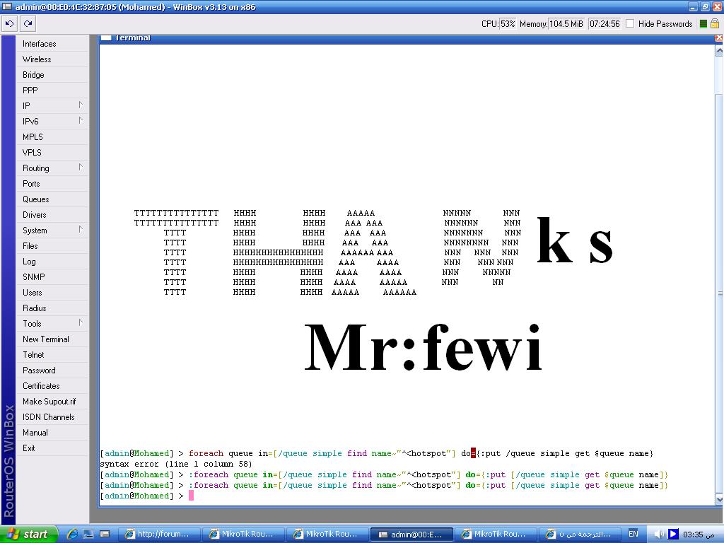

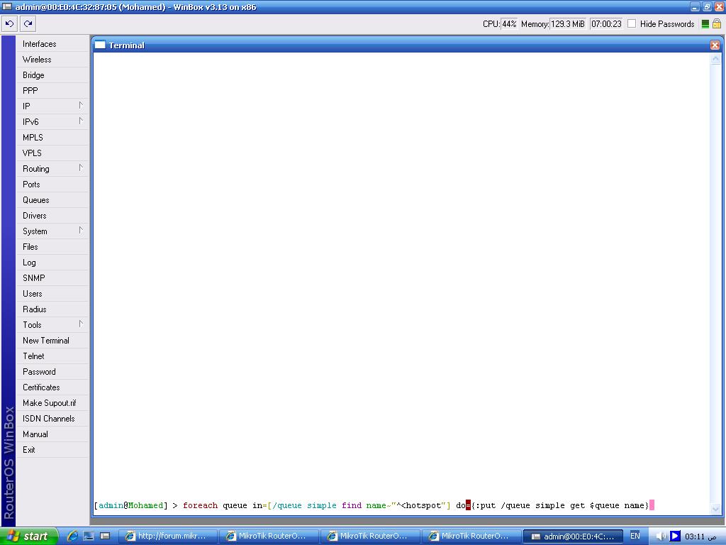

foreach queue in=[/queue simple find name~"^<hotspot"] do={:put /queue simple get $queue name}
If that doesn’t output anything, version 3.13 doesn’t support find by regular expression and the script cannot work on 3.13, and you’d have to upgrade to 3.30 (as stated earlier, the script works for me running 3.30). Maybe try upgrading anyway and see if it works.
ok thank u very mach and this is the out put of it
and i well tray to upgrading to 3.30 and tray but thanks thanks thanks !!! :slight_smile: :slight_smile: :slight_smile: :slight_smile: :slight_smile:
I’m sorry I was quickly posting that before leaving work and that code won’t run:
:foreach queue in=[/queue simple find name~“^<hotspot”] do={:put [/queue simple get $queue name]}
Try that instead. My apologies.
as welcom
I think that pretty much confirms that the script is incompatible with 3.13. I’m unable to downgrade anything to that to test myself, so I’m afraid I can’t help out any further unless you go up to 3.30.
