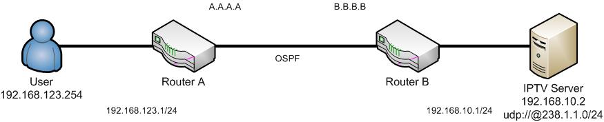

There are two abstract network. one is the source of IPTV.
is a problem: multicast routing from one network to another.
At the IPTV server default gateway 192.168.10.1
238.1.1.0/24 - multicast addresses
Router A

The client does not see IPTV. what’s wrong? what else would you show?

All remove and recreate by the description: http://wiki.mikrotik.com/wiki/Manual:Multicast_detailed_example
Router A
ether1 to User
ether2 to Router B

Router B
VIDEO_1PKT to Multicast sender
ether3_inet to Router A

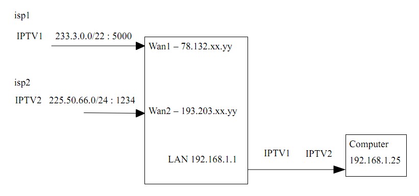

help to realize iptv viewing from both providers at the same time
please help!
Join to question
Up for help to realize iptv viewing from both providers at the same time
I’m definitely not an expert with multicast, but offhand, I would say that you need to configure the RP address for ISP1’s group to be ISP1’s RP, and a different RP for ISP2’s group.
If they just want IGMP from your device then you may just need to use IGMP proxy (no PIM), and set the group and upstream interfaces as static entries in the MFC tab.
