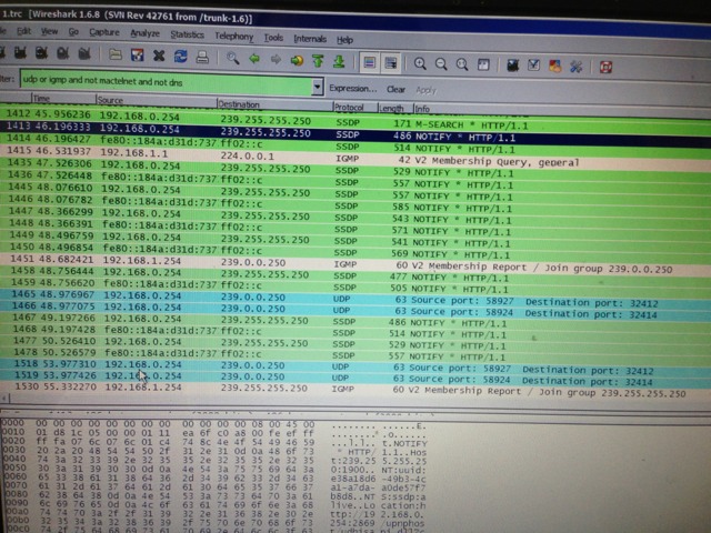

Heres a screenshot of a capture on the mikrotik eth2 interface, any help please? Should I really add an alternate address?
