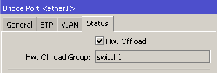

So is the Wiki wrong? Or is RouterOS reporting HW Offload wrong?
Thanks!
EDIT: turns out Winbox is reporting the HW Offload feature correctly, but the CLI is not. See the two attached captures from Winbox. So it seems this might be a CLI bug.
IGMP Snooping Disabled:
IGMP Snooping Enabled:
