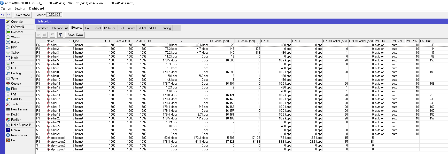

Streamers generate up to 190mbps traffic. I have selected VLAN for multicast traffic. All bridges on RBD52G-5HacD2HnD and CRS328-24P-4S+ IGMP Snooping.
I have a strange situation - on part of the ports from the switch to the routers, I get normal traffic for the channel requested by the TV set-top box (about 6 Mbit).
On the other part of the ports, the entire multicast stream from streamers goes to the routers.
I need to get to the router only the stream of the group that the prefix on the router port requests. Below are the configs of switches and routers.
How can I achieve this?

That behavior is covered in the second paragraph of the introduction section here.
All enabling IGMP snooping does is makes the switch aware that there’s a multicast stream going between the ports. The next question is, what do you want to do about each stream? Under the stock configuration, the CRS won’t guess, in the name of broadest compatibility; you have to tell it.
For IPTV, you probably want to disable multicast flood-by-default (first paragraph, same link) so a port has to explicitly ask for a stream before it will start flowing, and you also want to start an IGMP querier on one of your devices so abandoned streams get pinched off.
Having done this, you may then want to be sure all the other IGMP services are still working. Did you break mDNS, for example?
Incidentally, I suspect you should turn off the “trusted” flags on those apparently-unused bridge interfaces, the ones without VLAN tags, since you’re using DHCP snooping. If I understand your configuration properly, you should have only one trusted interface: the one going up toward the hAP ac².
