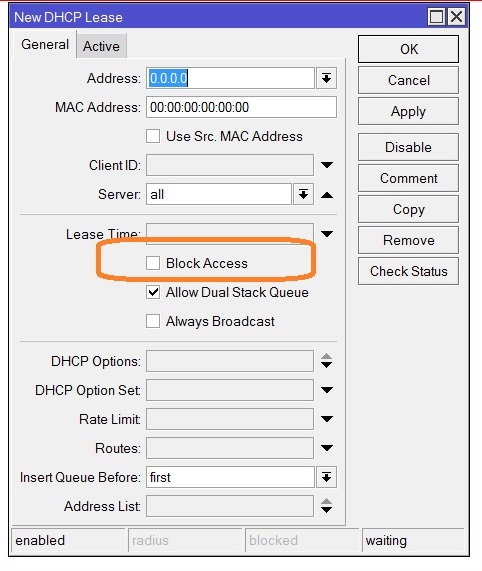

Doesn’t your RouterOS have Block Access checkbox like mine does? Or:
/ip dhcp-server lease
add server=<server> mac-address=xx:xx:xx:xx:xx:xx block-access=yes
So the idea being is that you statically set DHCP lease for tablet in public SSID, and then use block access check box.
You should also set Static DHCP lease for tablet on private SSID .
Hopefully that causes no hanging… Let us know.

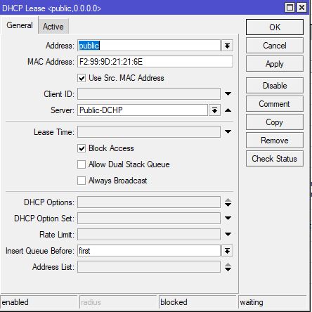

Thank you for help mates, so what I did: I’ve used on WInbox the button + and added manually as seen here, I’ve tried different combinations, use src MAC or not, allo dual stack or not, the device has delay to obtain the IP but finally it does use it, and I don’t see the log any block occured, pity that Mikrotik doesn’t log when it blocks DHCP so I can be sure about that. When I connect to the proper SSID I see the release, so the roule seams not interfeer with the right usage.
Chances are in my case, the device do remember the latest IP he used of that public network and try to use it again even if DHCP didn’t answer, does it has sense?
I’ve tried to forget the wifi network and connect again, reboot tablet and router, it behaves the same. I hope on next days it will definely forget that IP..

/system logging add topics=dhcp
And then in log:
18:56:32 dhcp,debug LAN received discover id 3870440748 from 0.0.0.0 '1:0:c:29:e0:d9:dd'
18:56:32 dhcp,debug,packet     secs = 58
18:56:32 dhcp,debug,packet     ciaddr = 0.0.0.0
18:56:32 dhcp,debug,packet     chaddr = 00:0C:29:E0:D9:DD
18:56:32 dhcp,debug,packet     Msg-Type = discover
18:56:32 dhcp,debug,packet     Host-Name = "CHR5"
18:56:32 dhcp,debug,packet     Parameter-List = Subnet-Mask,Classless-Route,Router,Static-Route,Domain-Server,NTP-Server,CAPWAP-Server,Vendor-Specific
18:56:32 dhcp,debug,packet     Client-Id = 01-00-0C-29-E0-D9-DD
18:56:32 dhcp,debug blocked lease
