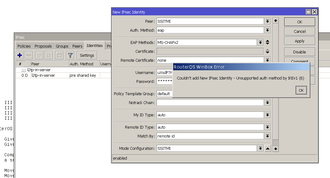

I am trying to intsall a surfshark VPN client on the CCR1009, Routeros 6.46.5
auth-method=eap
eap-methods=eap-mschapv2
certificate"surfshark_ikev2.crt_0"
gives me a nice “unsupported auth-method by IKEV1” on the terminal.

So I
  1. i have surfsharks certificate in certificates
  2. cancel certificate in IP–>IpSec–>Identities–>myprovider
  3. Apply --Z non change, see attached
  4. now I uploaded Your certificate and imported into System–>certificates
  5. retry with certificate field free —> non change
  6. retry with your certificate in the slot → non change

Here I got a fact:
the mikrotik tutoril for surfshark states peer–>address–>exchange-mode=main, in the tutorial you gae the link it’s exchange-mode=ike2
The rest is exaktly the same.
So I changed in exchange-mode=ike2 and … it accepted the identity setting!!!
Can it have been the problem?

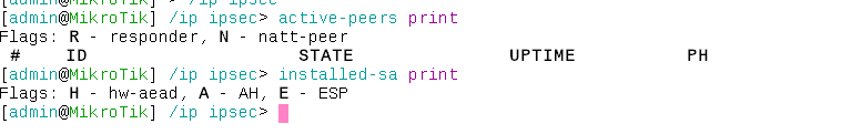

I checked in the terminal as stated in the tutorial, but do not understand the response:
so nothing should be active as I understand, but at least we got over stp 14 in the manual!
Indeed. It is a IKEv2 connection so that should be selected.
Looking in installed-sa shows the most info but you don’t have any info there and so the connection is not made.
