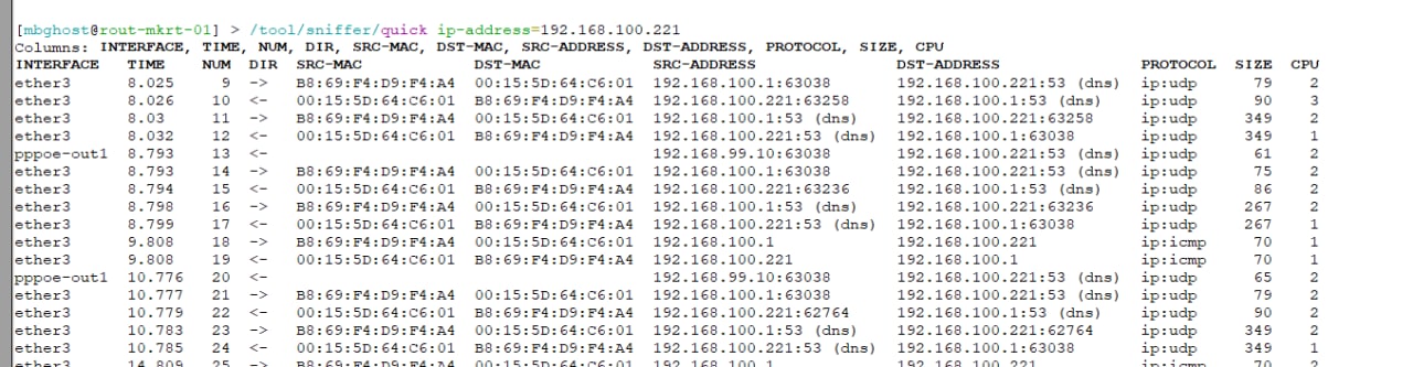

Third, the fact that the DNS server responds to pings doesn’t mean that firewall rules on the IPsec responder (server) router do not block DNS queries from the VPN clients. If you run /tool sniffer quick ip-address=ip.of.the.dns on the responder router, and then run ping hostname.of.some.pc on the initiator PC, what does the sniffer show? If everything was correct, you should see the query packet to come via the WAN interface (through which the IPsec SA is established), then leave via the LAN interface (if there is a bridge, you would see it once on the bridge and once on the physical interface), and then you should see the response to arrive via the physical LAN interface and, if present, the bridge. You wouldn’t see it on WAN because sniffer doesn’t show packets before IPsec encryption, but it shows them after IPsec decryption.

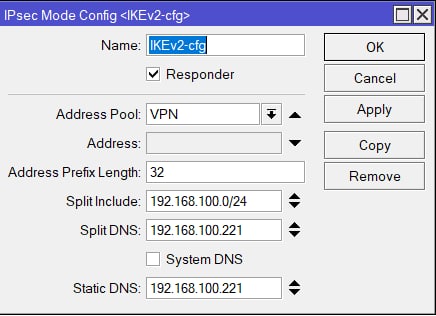

    My LAN network 192.168.100.0/24 and VPN -192.168.99.0/24, I tried with system DNS without it, set rule for DNS server, but same result
