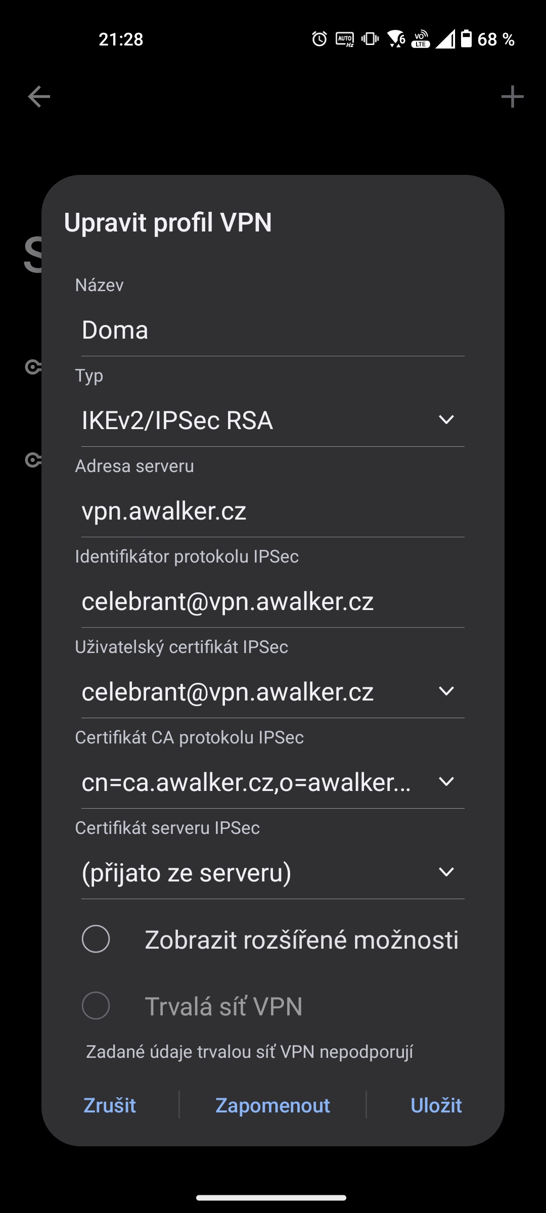

Hi, I’m having trouble setting up IKEv2/IPSec RSA vpn server with RADIUS for user auth.
My setup is: Mikrotik with ROS 7.9 → FreeRADIUS → OpenLDAP. VPN clients are Android 13 devices. I specifically want to authenticate users using their personal certificates as I already use those for WiFi (EAP-TLS). And because the certificates are stored in OpenLDAP, I need to use RADIUS. Which works great for WiFi, but not for IPSec. The problem is that the RADIUS server is not queried when a user is connecting using RSA (No requests are sent to the FreeRADIUS server, nothing in mikrotik log regarding radius). Therefore connecting to the vpn fails with
identity not found for server:vpn.awalker.cz peer: RFC822: celebrant@vpn.awalker.cz
But when I change the VPN type in my phone to IKEv2/IPSec MSCHAPv2 then the RADIUS server is used (FreeRADIUS gets the request).

Hello. I have tried to set “my-id” on server to fqdn “vpn.awalker.cz” and I have also tried my-id=auto with no success. my-id=“user fqdn” is not allowed for auth-method=“eap radius”.
