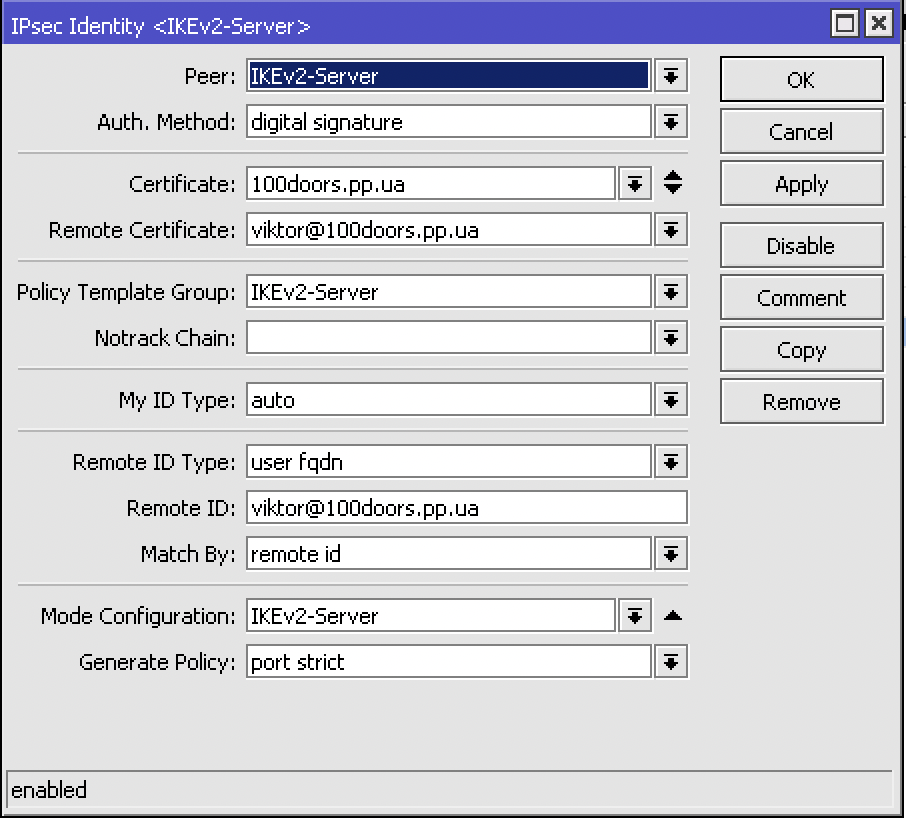

IKEV2 - problem to connect - identity not found for peer
i have problem to estabilish connection between computer (mac) and mikrotik RB2011
at log i have error Identity not found for peer:FQDN: client.vpn.ikev2
can you help me to fix issue? Thank you.
jun/22/2020 15:30:07 by RouterOS 6.46.4
software id = 8DG7-UNSH
model = 2011UiAS
serial number = B9180AC59CAC
/ip ipsec mode-config
add address-pool=VPN-IKEv2-POOL address-prefix-length=32 name=“VPN IKEv2”
split-include=0.0.0.0/0 static-dns=x.x.x.x,8.8.8.8 system-dns=no

/ip ipsec identity
add auth-method=digital-signature certificate=vpn.ikev2 generate-policy=
port-strict match-by=certificate mode-config=“VPN IKEv2” my-id=
address:x.x.x.x peer=IKEv2 policy-template-group=“IKEv2 Group policy”
remote-certificate=client.vpn.ikev2 remote-id=user-fqdn:client.vpn.ikev2

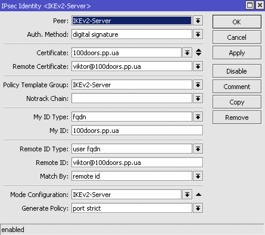

It seems that the MacOS client provides another ID than user-fqdn. Only a detailed log can show you what comes from there and how to match the identity.
Switch logging of IPsec details on:
/system logging add topics=ipsec,!packet
then, run
/log print follow-only file=ipsec-start where topics~“ipsec”, let the client attempt to connect, and when the connection attempt fails, stop the /log print … and read the file.

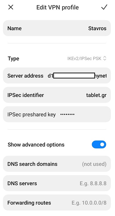

Hi guys,
Currently I have the same problem and I need your help about this.
First of all, I need to say that I had set my TIK as an IPsec server, creating some identities for different users, wanting to use IKEv2 PSK.
I mean, I only wanted to use username/password, without any certificates.
Please check the attached picture of a user configuration.
I can assure you that this was working pretty fine.
Suddenly, without any possible reason, my Android phone cannot get connected.
I’m getting this as a Debug Output on the router
15:58:03 ipsec requested server id: d1530…c.sn.mynetname.net
15:58:03 ipsec,error identity not found for server:d1530…c.sn.mynetname.net peer: FQDN: User3
15:58:03 ipsec reply notify: AUTHENTICATION_FAILED
15:58:03 ipsec adding notify: AUTHENTICATION_FAILED
What I can only assume is that recently my phone got a firmware update, but I cannot be sure if this caused the problem.
Because my phone cannot get connected by the same way on another router where it was also used to get connected, while on this specific one, my client’s devices (don’t know if they are Android or iOS), still get connected without any problem.
Any suggestion?
Kind regards
Stavros

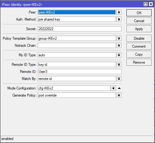

Hi Sindy,
Here is the ipsec output and the Android config you asked about.

/ip ipsec identity
add generate-policy=port-override mode-config=cfg-IKEv2 peer=peer-IKEv2
policy-template-group=group-IKEv2 remote-id=fqdn:tablet.gr
policy-template-group=group-IKEv2 remote-id=key-id:User1
policy-template-group=group-IKEv2 remote-id=key-id:User2
policy-template-group=group-IKEv2 remote-id=key-id:User3
policy-template-group=group-IKEv2 remote-id=key-id:User4

Not much to see in the Android configuration. So as the first step, I would set my-id=fqdn:xxxxxxxx.sn.mynetname.net on the /ip ipsec identity row for that Android client, so that the IPsec ID would match the way how the responder address is configured at the Android.
Sindy,
What can I say?
It totally worked!!
You are a genius!
So, since this happened just after my phone upgrade, it’s totally its fault right?
Not the mikrotik’s?
Thank you very much!
Stavros
Sounds like that. Except that it may not be a “fault” but an “improvement” :slight_smile:

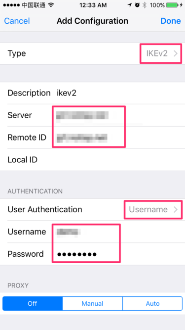

Hi Sindy,
Thank you very much again and sorry for the delayed answer, but we were on summer vacation here in Greece.
Well, as I told you, the Android connection error seems fixed!
But, we are facing the same problem with manager’s iPhone device.
I don’t know if you could give us a hint as well.
In the attached picture you can see a typical iPhone interface.
Server - VPN Server Address
Remote ID - VPN Server Address (must be a domain name)
Local ID - leave it blank
Account - VPN username
Password - VPN password
Is the above configuration right? I mean, Server and Remote ID needs the mynetname domain?
Do you have any idea?
Kind regards
Stavros
First, is it indeed the same problem, i.e. do you again get an “Identity not found for peer” error?
If so, search the topics here regarding IPsec logging into a file (search phrase for uncle Google: site:forum.mikrotik.com /log print follow-only where topics~“ipsec” novels) and post the log collected when the iPhone attempts to connect.
The thing is that the iOS may not support pre-shared key with IKEv2 but require a certificate at least at responder (Mikrotik side) and the username and password may be used for EAP authentication, so you would need a RADIUS server. Plus iOS has quite strict requirements on certificate properties (relatively short validity, maybe some minimum key strength).
The log should reveal how the iOS is trying to authenticate; logging with different settings at the iPhone (what are the alternative choices for User Authentication?) into separate files should show the easiest way to use.

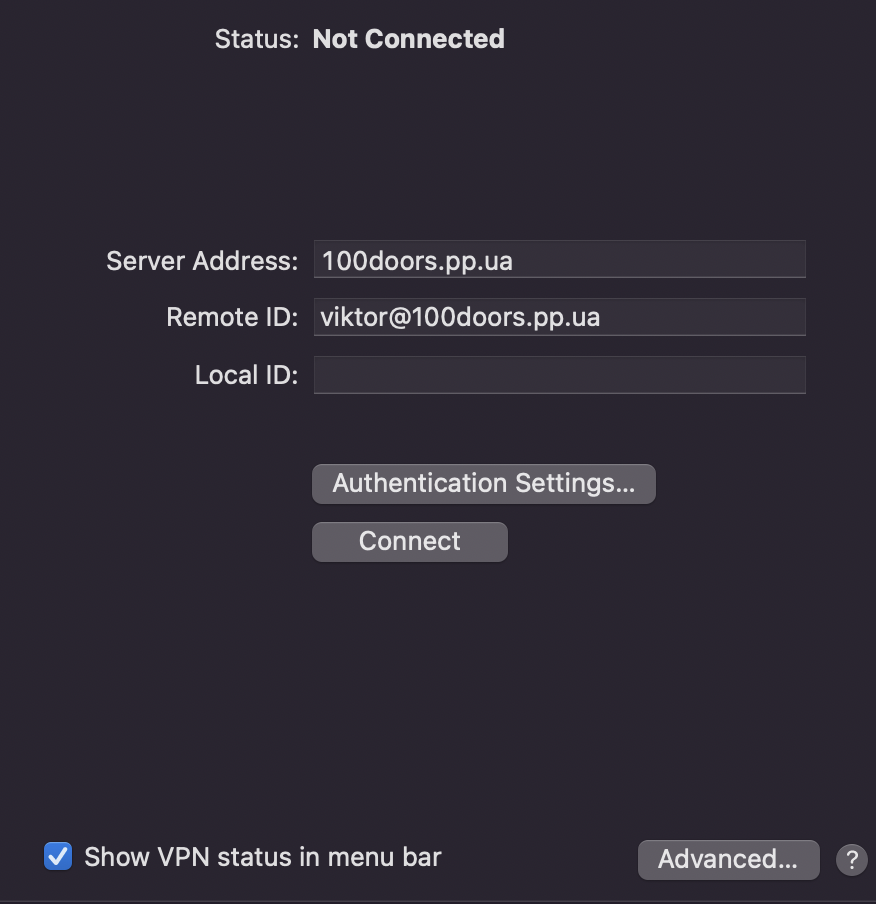

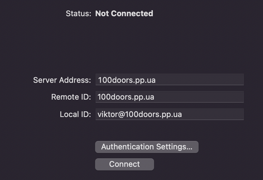

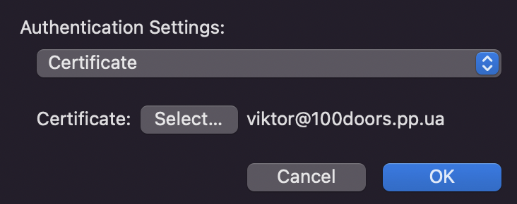

Please, help me fix issue with IKEv2 and mac OS, im stuck and have no idea what to do. I have Mikrotik hex with IKEv2 server and issued CA, server and user cert. Its works pretty good with windows, but not with mac.
I import CA and user cert to system, but it falls with identity not found for server:server.pp.ua peer: RFC822: viktor@server.pp.ua

sep/13 00:59:01 ipsec processing payload: ID_I
sep/13 00:59:01 ipsec ID_I (RFC822): viktor@server.pp.ua
sep/13 00:59:01 ipsec processing payload: ID_R
sep/13 00:59:01 ipsec ID_R (FQDN): server.pp.ua
sep/13 00:59:01 ipsec processing payload: AUTH (not found)
sep/13 00:59:01 ipsec requested server id: server.pp.ua
sep/13 00:59:01 ipsec,error identity not found for server:server.pp.ua peer: RFC822: viktor@1server.pp.ua
sep/13 00:59:01 ipsec reply notify: AUTHENTICATION_FAILED
sep/13 00:59:01 ipsec adding notify: AUTHENTICATION_FAILED

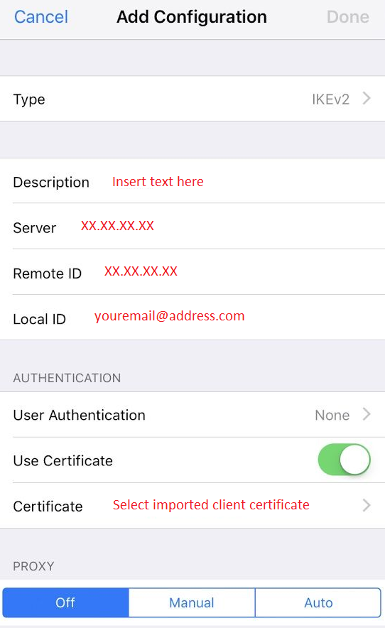

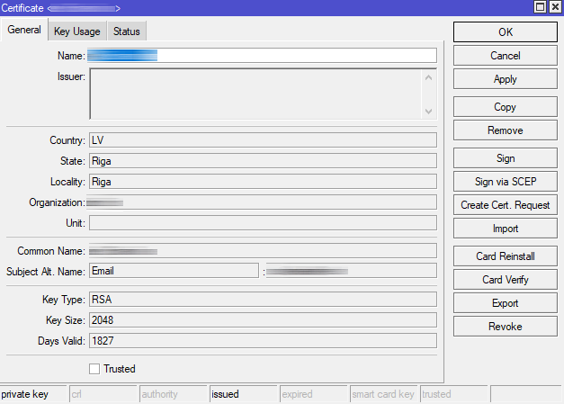

Maybe the method I use for iOS will be useful for someone.
Create certificates:
/certificate
add common-name=XX.XX.XX.XX name=XX.XX.XX.XX
sign "XX.XX.XX.XX" ca-crl-host=<router local IP>
add common-name=XX.XX.XX.XX subject-alt-name=IP:XX.XX.XX.XX key-usage=tls-server name="IKE2 RSA server"
sign "IKE2 RSA server" ca=XX.XX.XX.XX
add common-name=Client name=Client key-usage=tls-client
sign Client ca=XX.XX.XX.XX
export-certificate Client export-passphrase=SuperStrongPass123 type=pkcs12
Before signing the client certificate, fill in a few more fields in it:
Other configuration related to IKE2:

Create a new IKE2 VPN on iOS 14+:
I used this method a couple of days ago on iOS 15, it worked
You have shown the log but not the configuration, namely, how does the /ip ipsec identity row for the macOS device look like. The macOS sends the “e-mail address” as the identity, so the remote-id field of the identity must be set to user-fqdn:viktor@server.pp.ua and the match-by field must be set to remote-id in order that the identity row could be found for that type and value of ID-I. But that doesn’t mean that it will work afterwards. What @Fesiitis has posted shows match-by=certificate on the identity row at the Mikrotik side but at the same time the local ID is in the user-fqdn format at the iOS 15 side, so it seems strange to me. But I’d have to see what the iOS with those settings actually sends in the initial IKEv2 packet.
Also Apple has some requirements on maximum certificate validity period and maybe minimum algorithm strength, so it may behave different with a certificate it likes (and thus uses) and with a ertificate that doesn’t meet its security requirements.
I try different combinations in identity parameters, try to set match-by=certificate and match-by=remote id, but it doesn’t work. I will attach screenshots from mac and full log from mikrotik.
ipsec_log.docx (13.4 KB)
With nothing set as Local ID in the Apple settings, the Apple device uses its current IP address as an initiator ID. That address will change depending on where and when you connect the Apple thing to internet. So please configure it in such a way that the local-id on the /ip ipsec identity row matches the Remote ID value in the Apple client settings, and the remote-id matches the Local ID value on Apple, and set match-by=remote-id on the identity row.
Also, better to post the log as plain text than a .docx - less place for malware to hide in.
I did what you say, and it didn’t help. I try to set ip address and domain name in My ID

19:39:48 ipsec ike auth: respond
19:39:48 ipsec processing payload: ID_I
19:39:48 ipsec ID_I (RFC822): viktor@100doors.pp.ua
19:39:48 ipsec processing payload: ID_R
19:39:48 ipsec ID_R (FQDN): 100doors.pp.ua
19:39:48 ipsec processing payload: AUTH (not found)
19:39:48 ipsec requested server id: 100doors.pp.ua
19:39:48 ipsec,error identity not found for server:100doors.pp.ua peer: RFC822: viktor@100doors.pp.ua
19:39:48 ipsec reply notify: AUTHENTICATION_FAILED
