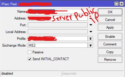

After spending a lot of hours trying to config the server (Ubuntu) and client (Router 4011 (behind NAT-dynamic ip)) it’s finally established the tunnel and it’s automatically create a NAT rule and there is no internet on devices (I tested the vpn on android client and it’s working fine the android phone which is using the same internet as the router) and also I can’t ping the server public ip with router. I know firewall and other part should be configurate but I don’t know how. I want all of the traffic of the router (all of my devices) route through this IKEV2 vpn. so I would highly appreciate it if any of you can help me with this.
also be able to route the traffic of some IPs out of that vpn, for example all traffics are going through VPN except for ip 222.222.222.222. I opened a topic before and got the solution for it but in that time I was using L2TP I don’t know if it’s the same or not.
I tried setting the address list and set it for mode configs as been said in manual but no difference.
Any idea?

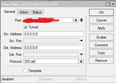

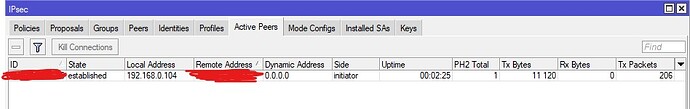

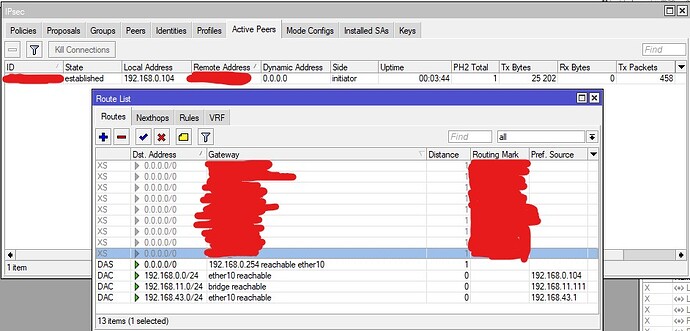

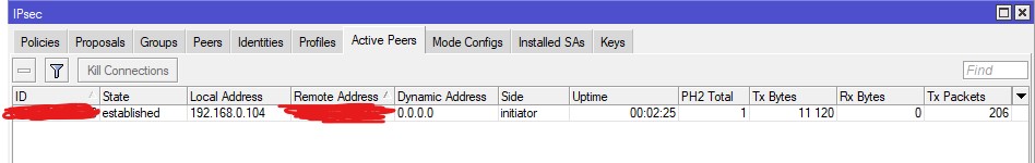

I tried with /ip ipsec policy add dst-address=0.0.0.0/0 peer=ubuntu.xentoo.info proposal=ubuntu.xentoo.info src-address=192.168.43.1/32 tunnel=yes too but same, also like I said in the first post I got that dynamically generated action=src-nat rule before too and now I can ping the ip server too but no data is coming (Rx) but I got (Tx) As you can see here:

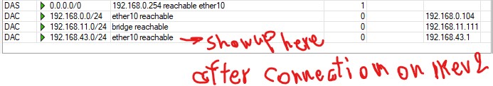

My Route List:

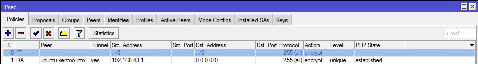

Also I tried with /ip ipsec policy set 0 proposal=ubuntu.xentoo.info the default policy which generate a dynamic one as you can see here:

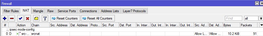

and this is the dynamic action=src-nat:

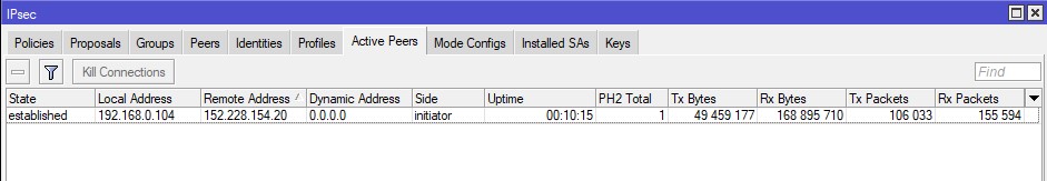

I was checking the server and just reboot it (server) and then vpn on router start working:

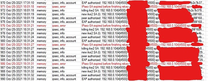

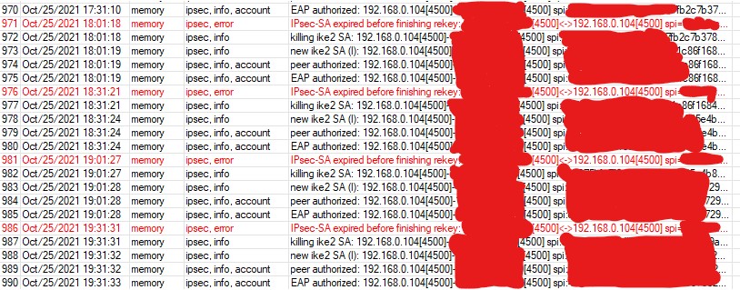

Is this normal?:
No, it is not normal. The rekeying of the data SA seems to fail and as a consequence, the whole IPsec session gets re-established.
My wild guess is that it is caused by different interpretation of the RFC regarding PFS, try setting pfs-group in proposal to none. In IKEv2, PFS is used always, using the algorithm specified in dh-group in profile, and other setting than none is necessary only for some peers.

Thank you very much, I disable peer - identity - policy and then enable them again in order peer => identity => policy and so far for about 1:30 hour it’s been running without rekey error, if it’s start to show that error again I will change pfs-group to none as you said.

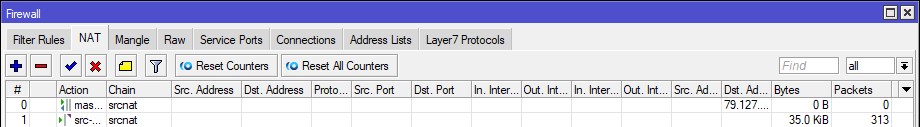

It’s not working. Not manual case neither dynamic case. it’s not bypassing the vpn for 111.111.111.111.
Show me /ip firewall nat print in the “manual” case while the tunnel is up.
here you are:
[@MikroTik] > /ip firewall nat print
0 chain=srcnat action=masquerade dst-address-list=79.127.127.21 log=no log-prefix=“”
1 chain=srcnat action=src-nat to-addresses=192.168.43.1 log=no log-prefix=“”
