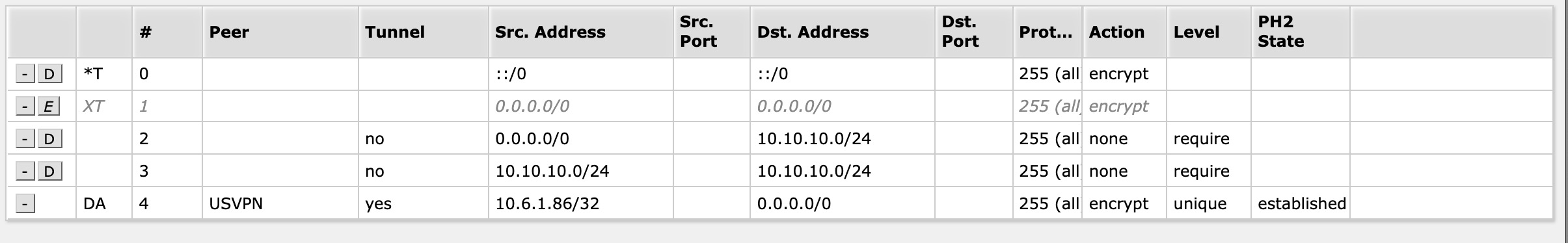

I created the policy, however, I’m not sure if I should keep the ones I setup originally. Is the order correct?
action=none src-address=10.10.10.0/24 dst-address=10.10.10.0/24. It has to be placed before (above) the template policy used by the /ip ipsec identity row of the IKEv2 VPN.
[/quote]
As you haven’t posted the complete configuration in the OP, I’ve made a guess, and the guess was wrong. So the policy #3 on the screenshot, which I have proposed, is useless and you can remove it; it’s policy #2 that should make the PMTUD work.
If it does, all is good and the only thing to do is to move it before current #0 (the only enabled template) so that once you disconnect and re-connect the VPN, current #4 would not be created before (above) current #2.
If it doesn’t, my assumption was wrong and something else is wrong.

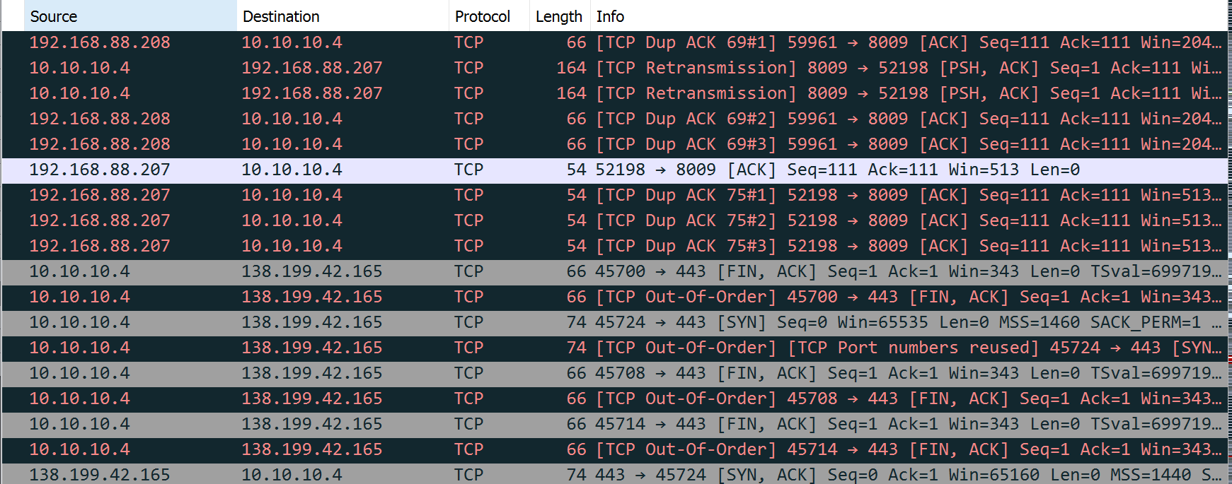

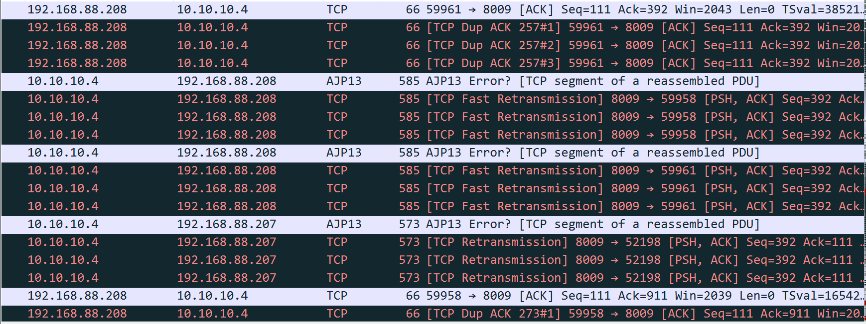

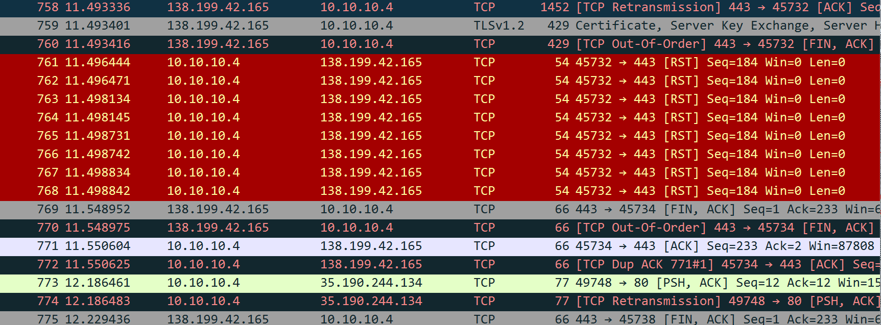

Not really sure what to look for, here is what I see. Netflix server seems to be 138.199.42.165:
Well, the actual pcap files are necessary for a serious analysis, the screenshots are useless. That’s why I was mentioning a local friend who can use Wireshark to analyse things.
What I can see from the screenshots is that your sniffing method creates duplicate packets in the resulting .pcap, what exactly does your current sniffing setup look like?
