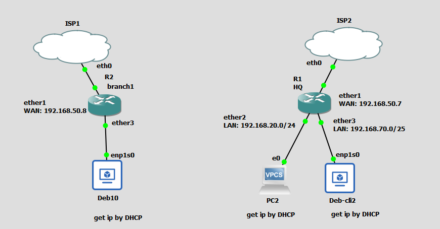

Hm… I just wiped out the entire configs and
I have now following situation:
R1 [WAN:192.158.50.7] (HQ)
modecofig

R2 [WAN: 192.168.50.8] (branch1)
/ip ipsec peer
add address=192.168.50.7/32 exchange-mode=ike2 name=R1 profile=R2

In this case R2(+.30/24) can ping anything on R1(+.20/24 .70/25)
BUT R1 can’t ping anything on R2
As I’ve mention I’m not such a guru in mikrotik… and have no clue what do I miss :frowning:
