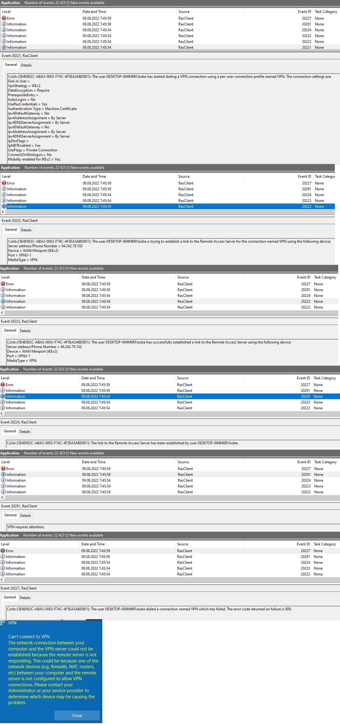

I did exactly same steps like in this guide. When I tried connect to VPN, Windows says this:

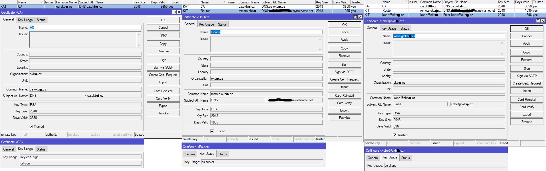

subject-alt-name is DDNS of Mikrotik. Win Firewal is turned off, I also tried AssumeUDPEncapsulationContextOnSendRule register. Firewalls rules are at top of all rules.

Sorry, didn't know that. Screenshots at attachment. I asked on Redit and I asked also here. Sorry if I did something wrong, just want to get it work.

/ip ipsec identity add auth-method=digital-signature certificate=*A generate-policy=port-strict match-by=certificate mode-config=modeconf-vpn peer=peer-WAN policy-template-group=group-v
pn remote-id=user-fqdn:kobe@domain.com
/ip ipsec policy add dst-address=10.10.10.0/24 group=group-vpn proposal=proposal-vpn src-address=0.0.0.0/0 template=yes
/ppp secret add name=vpn

Have you permitted incoming connections to UDP port 4500 (chain input of /ip firewall filter)? Since there is a NAT between the responder (the Mikrotik) and the initiator (the Windows machine), the IKE connection migrates from port 500 to port 4500 once the presence of NAT is detected.
OK, you have, even twice (you’ve added the export before I’ve responded). However, the log does not indicate any packet to arrive to port 4500. Is it possible that there is another firewall between the Windows machine and the Mikrotik?

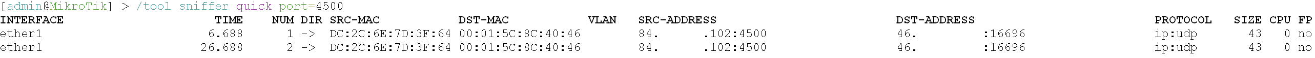

Can you open a command line window, make it as wide as your screen allows, run /tool sniffer quick port=4500 in that window and try to connect the Windows client again? I’m interested in whether any packet arrives to port 4500 at all, and if yes, what is its size. There may be an issue with handling of fragmented packets somewhere between the devices.
There is no other firewall between. Maybe ISP? Sniffer in attachment. Thank you for helping. (I also screenshot set of certificates)
how long was the sniffing for?
form the result that you got , we can clear see that u are not getting response @sindy will give u more info.
i will play first with pre shared key, once u see that everything is working that you can switch over to certificate.
So that’s it regarding hiding your IP addresses… maybe withdraw the screenshot, use some more spray and re-post it?
