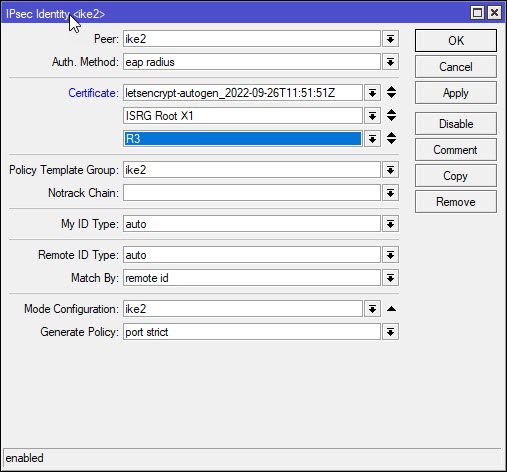

Thank you. Mikrotik help page really need to add this into their page. To those anyone who are having problem, you can download the Intermediate cert https://letsencrypt.org/certificates/. Download both of ISG root X1 and R3.
Problem solved.
Thanks a lot, this worked for me too. Just wanted to add that it’s not required to add both the root “ISRG Root X1” and the intermediate “R3”. Just with the intermediate certificate is enough as the root certificate is already present in the OS.
