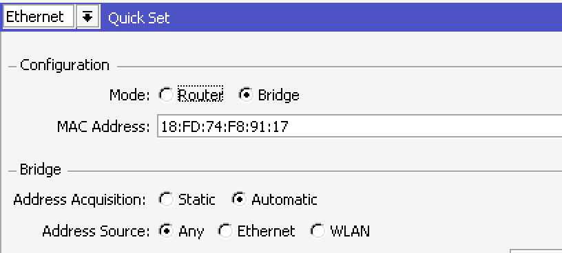

I am specifying “Bridge” on the quick config page.
Yes, and that’s what you’re getting. Your mistake is assuming “bridge” means the same thing to you as it does to the MikroTik employee who wrote that piece of Quick Set. What it gives you is a perfectly valid implementation of the “bridge” concept; it merely isn’t your preferred concept.
Neither is wrong; both have their purposes.
Your best bet is to begin understanding what Quick Set does and not assume its defaults are wrong, but at worst mistargeted to your particular situation and preferences. Once you know what it does, you can adjust what it gives to suit. That’s the beauty of RouterOS; you aren’t locked into someone else’s web UI configuration interface, along with their ideas of what it is you need.

You’re not wrong here. On some models, QuickSet would be able to migrate the config from a “routed” mode to a “bridged” mode. There are “profiles” in QuickSet that have different templates, but not all profiles are on all models.
BUT… what’s particularly annoying is the newer hAPax2 and hAPax3 do NOT have any QuickSet profile that allows changing the default configuration into an “AP Bridge” - which is the mode you’re looking for. On the hAPax things, there is only the “Home AP Dual” profile, so QuickSet isn’t going to help.
While on something like RB5009, the “Ethernet” profile allows setting bridge mode - but that won’t be on a hAP’s:
It’s kinda annoying they don’t offer the same simple way to convert an hAPax into a “bridged AP”. Ironically, on OLDER APs there would a QuickSet mode to do this – it’s only the NEWER AX models that seem to skip this option in QuickSet. So… essentially unwinding the default configuration to remove the DHCP server, set DHCP client on “bridge”, remove ether1 from WAN interface-list, and adding ether1 to the bridge is about all you can to do - as detailed above is about you’re only option.
