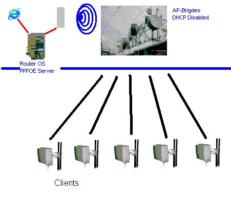

Based on the pic attached, How will the clients know where the server is located. Say the AP routes them, How do I configur the AP’s to do that or will they automatically know. Another Q
what do I configure my PPPOE Radio as, Brigde, Ap, or Client
there must be a bridge in between the client and the server, then they will know. PPPoE server doesn’t need an IP, clients discover it by service name.
you can’t have the server in some other network, it must be either direcly on the same network, or at least the inbetween device must be a bridge
Or use PPPoE relay.
