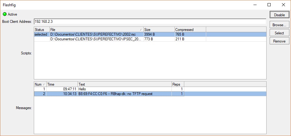

I'm unable to make flashfig work!

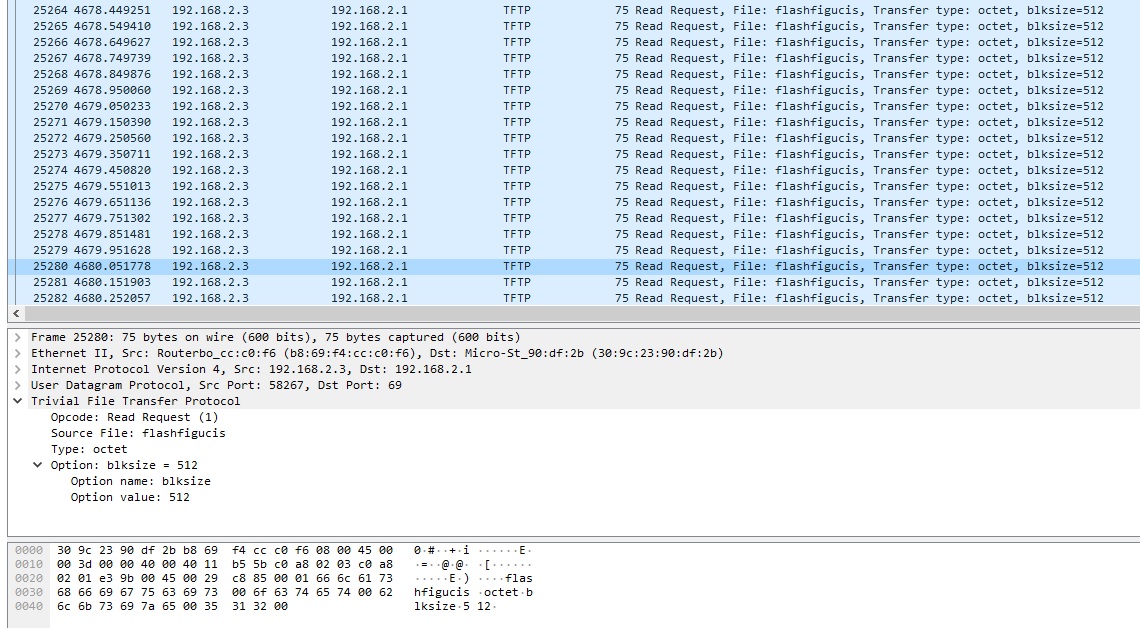

I need to configure several routers and the flashfig seems to be ideal solution for this, but I’m unable to make it work properly, had created a config file with size under 4K. I tried with several ‘out of the box’ routers and other setting in ‘System - Routerboard - Settings → flashboot / flashboot once’ in both cases the flashfig shows a message saying ‘XX:XX:XX:XX:XX:XX – RBhap-dk: no TFTP request’ in the wireshark I saw tons of packets with the ip flashfig provides to the router as source requesting to the PC a file named ‘flashfigucis’ and there is all, nothing more happens,so i’m a bit desperated

Confirmed with netstat that the 69 port is open in the pc listening petitions as you can see in the wireshark screenshot…
