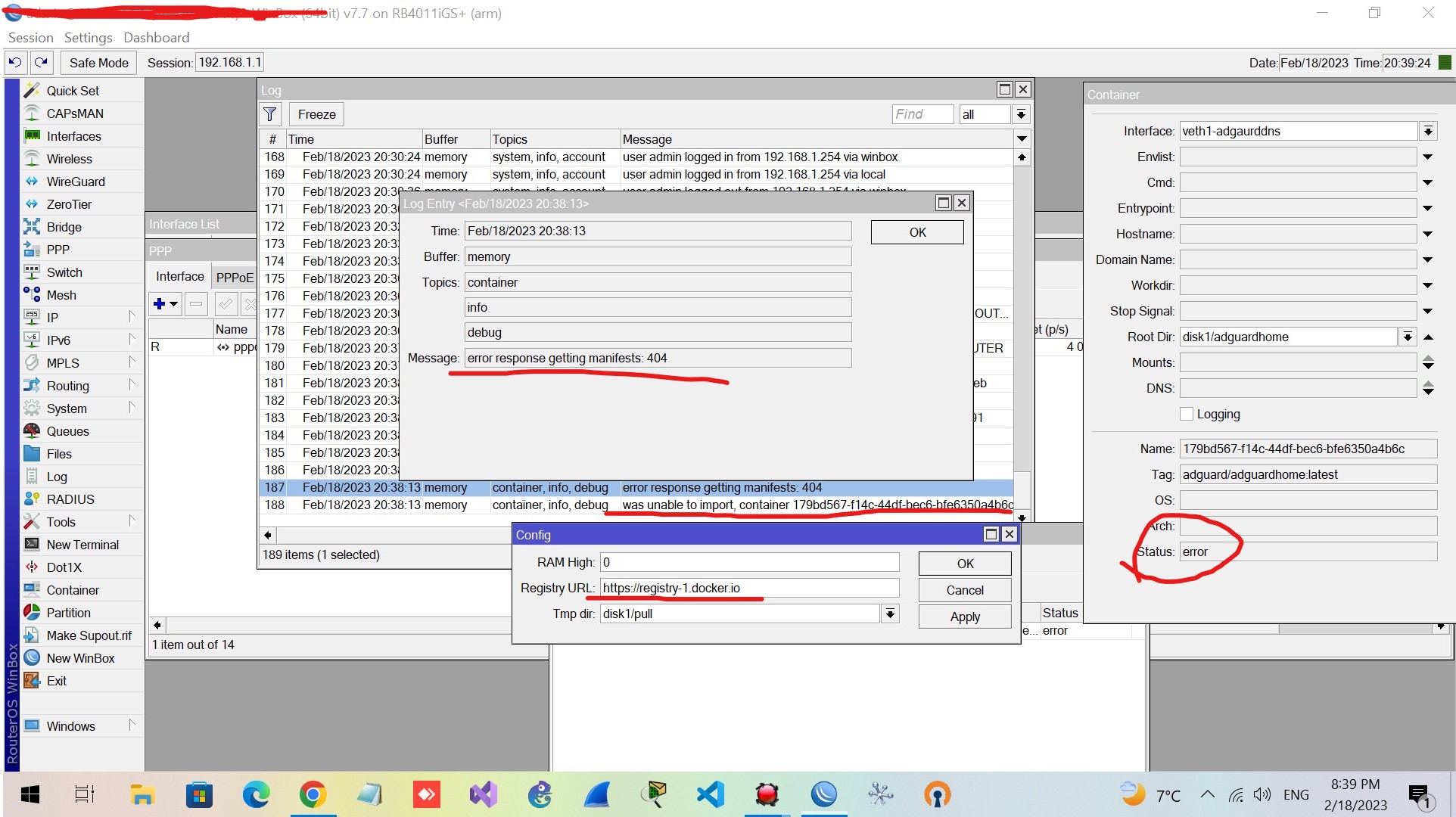

hello everyone,i have problem when i want to install or pull the docker image the problem is (error response getting manifests: 404)
when using( https://registry-1.docker.io) its just not there any more so ,what to use for the registry URL

“error response getting manifests: 404”
“was unable to import, container 150b8c16-e633-4ade-9f88-61dc463961c5”
