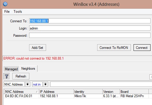

Impossible to configure the Metal 2SHPn
After a first configuration of Metal 2SHPn, winbox displays an error message when I try to see my configuration.
The message is displayed using the address ETH1 or WLAN. No access also via WebFig.

you should try connect to Metal 2SHPn by mac address.
I have use Mac address of Eth1 and Wlan, mjsabri, please.
