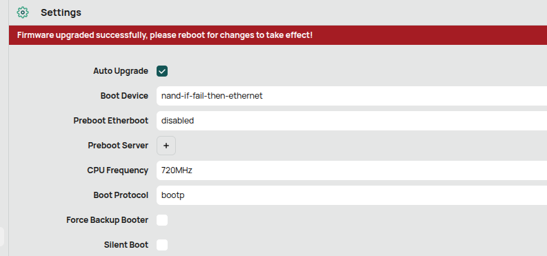

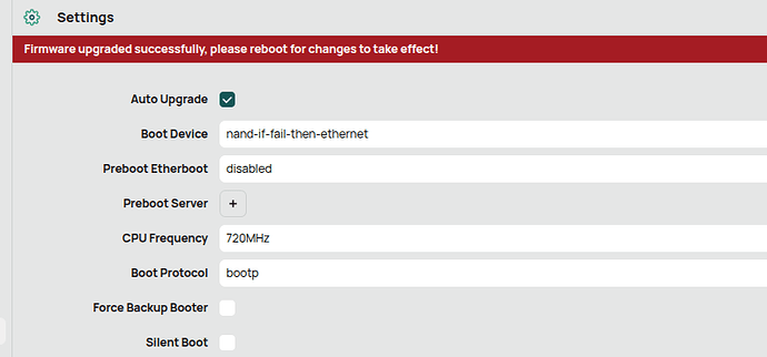

Can you try this from terminal:
/system device update routerboard=yes
You can also set the options from System / RouterBOARD / Configuration Settings to Auto Upgrade(this is only the RouterFW), so when updating the RouterOS it's also upgrade the RouterFW, but you have to reboot the device twice. I think this is not recommended from the community, but it there.
Correct but to set that, you also need to have routerboard=yes in device-mode ...
