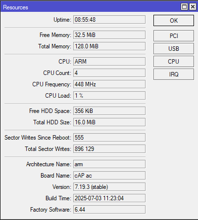

Sorry, my bad, I confused this with the CAP AX. The discriminating factor as to which driver is, AFAICS, the size of Storage on the device. 128MB devices can take wifi-qcom. Smaller devices can only take wifi-qcom-ac.
Not really, the discriminating factor actually is the used chipset, ARM based.
IPQ-4018-devices can use wifi-qcom-ac.
That's for cap AC, cap AC XL, AC2, wap AC (arm version, not mipsbe version), ...
And yes, all of those have 16Mb storage as limit.

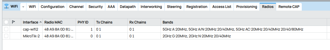

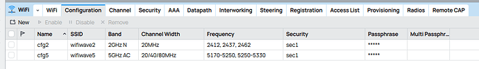

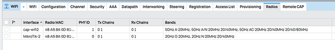

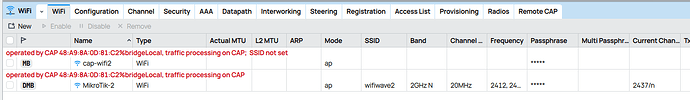

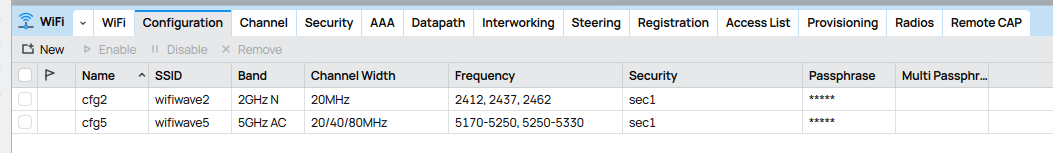

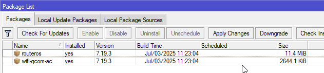

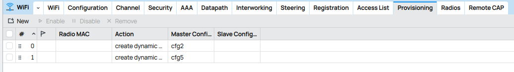

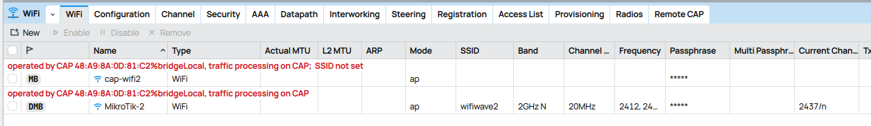

I installed valid packages on both devices and I’m trying to run it - 2.4ghz seems to be working, but for some reason 5ghz does not work. I checked my config multiple times, asked AI for some hints but cannot find the answer. Is it some other limitations that I;m not aware of?
