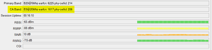

I use the lovely hAP ax lite (LTE6) as a roaming device, often running off a power bank. It’s an ideal portable mobile internet router. I’ve just upgraded it to v7.20.1 and also firmware 16121.1034.00.01.01.10. I’m pleased to report a much improved mobile connection in my house which was often quite poor. Specifically, I never got a CA band even outside my house and now it’s there all the time:
