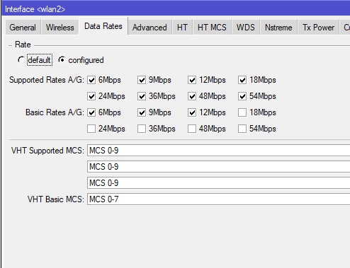

You mention the datarates several times. How am I supposed to raise the VHT rates (I’ll stick to AC-only) ?

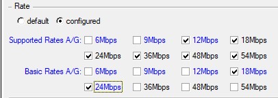

This is a very special parameter! Wifi retransmits a packet by retries (3 times # of HW retries, then steps down one MCS level) repeat until MCS0, if that double fails, then retries during “Disconnect timeout” , if it still fails then disconnects and drops the packets for that connection. Wifi normally does not drop packets. TCP flow control is done over negotiations (window, buffer, RTD, missing ACK). See https://wiki.mikrotik.com/wiki/Manual:Wireless_FAQ for the MKT implementations (other brands use other algorithms for retransmits and rate adjustment, sometimes you have an option to choose)
I don’t know why it is hidden in the GUI. If you set it as “configured” under data rates, then it appears.
Default values:
To be tuned like this for less overhead:
To estimate the impact: use http://www.arubanetworks.com/assets/vrd/Aruba_Wi-Fi_Frame_Time_Calculator-VHD_VRD_V2.xlsx (error in right table, Data rate A-MPDU)
