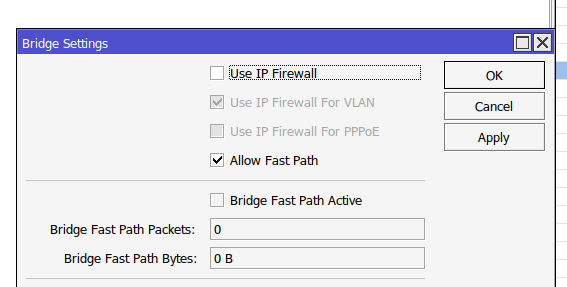

This setting doesn’t make much sense to me:
It’s enabled by default for some reason but this setting only does any thing if use-ip-firewall is enabled on the bridge. I don’t have that setting enabled so the value for this flag is meaningless. I tried disabling it any way but it doesn’t work.
So if you’re not really sure why you actually need it (no, you don’t need it to push inter-vlan traffic through firewall), you should set it to no.

Really?
I have the same device and ip firewall is not selected by default, nor could I find it in your config which is a big bloated thing more concerned with blocking stuff instead of
basically allowing traffic and drop all else.
Press the settings button on the the Bridge tab.
It’s been reported in another thread (I’m not searching for it, you can do it if you don’t trust my word) that 7.8 has a bug that if setting is enabled, it doesn’t get inactive if use-ip-firewall is disabled. So you have to enable use-ip-firewall, disable use-ip-firewall-for-vlan and disable use-ip-firewall again.
The setting (when active) means that tagged traffic, passing bridge, will be subject to firewall rules … even for intra-vlan traffic. For inter-vlan traffic, IP firewall rules will get triggered in all cases because that traffic is handled by router’s IP layer.

That was it! I enabled use ip firewall, applied changes, disabled use ip firewall for vlan, applied again, disabled use ip firewall
and now I am getting ~930mbps speeds across vlans. (Bridge fast path activated automatically after this)
