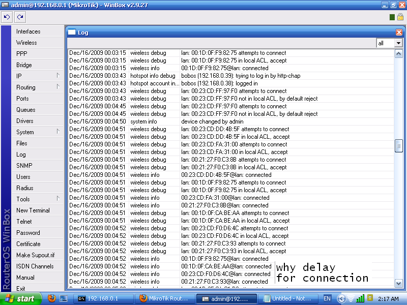

in local ACL,accept But not connected
I have ROS 2.9.27,engenius3016s as AP and 50 clients. Maximum 24 clients are present in regestration table at the same time
I remove default authenticate and add mac addresses of clients in access list.
my problem when I reboot the server, no client can connect to AP
some clients can connect but others cannot connect
I change configurations of engenius card tell clients can connect But when reboot server the problem begin again and so on
this problem last for 1 month till yet and I cannot understand why clients cannot connect.
the signal of clients between -83,-65

these are logs indicate acceptance of clients by access list But not connected.It must tell @lan connected so clients can be shown in regestration table, but this is not occur
also in this picture show four clients want to connect
but there is delay for connection. They connected together in 4:52
this picture show no delay for connection

Can you tell me what happens?
Update to 2.9.51 it is free of charge not cost anything but resolve many bugs and add new feature or if your license allowed update to 3.30.
3 version have many many improvements in the wireless, wireless perform much better :slight_smile: . You are using very old version.
