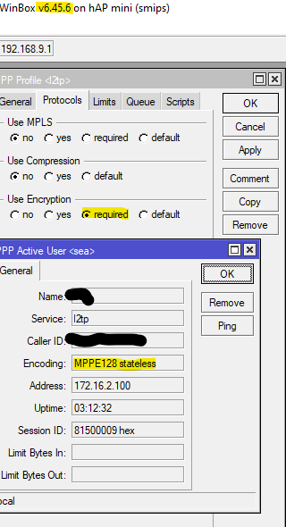

PPP - Active Conections - Column Encoding is empty when i disable IPsec.But there should be MPPE128 stateless.

Set it to required.
Mrdude go to the active connections tab, double click the connected client and see if the encryption is mentioned there…
