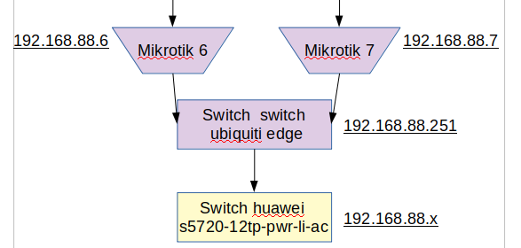

Two routers (with two internet sources) connected to a switch that distributes the packets, but both are masters and running at the same time :frowning:

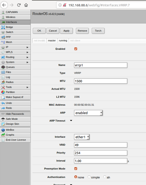

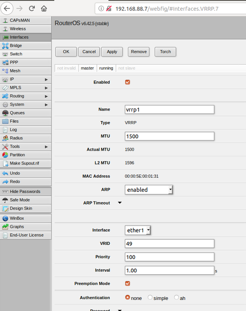

With a first router, called 6, with priority 254 and the second, called 7, with priority 100, as shown in the figures.

Looks like your input firewall rules on the vrrp-carrying interface are blocking vrrp traffic.
-Chris
