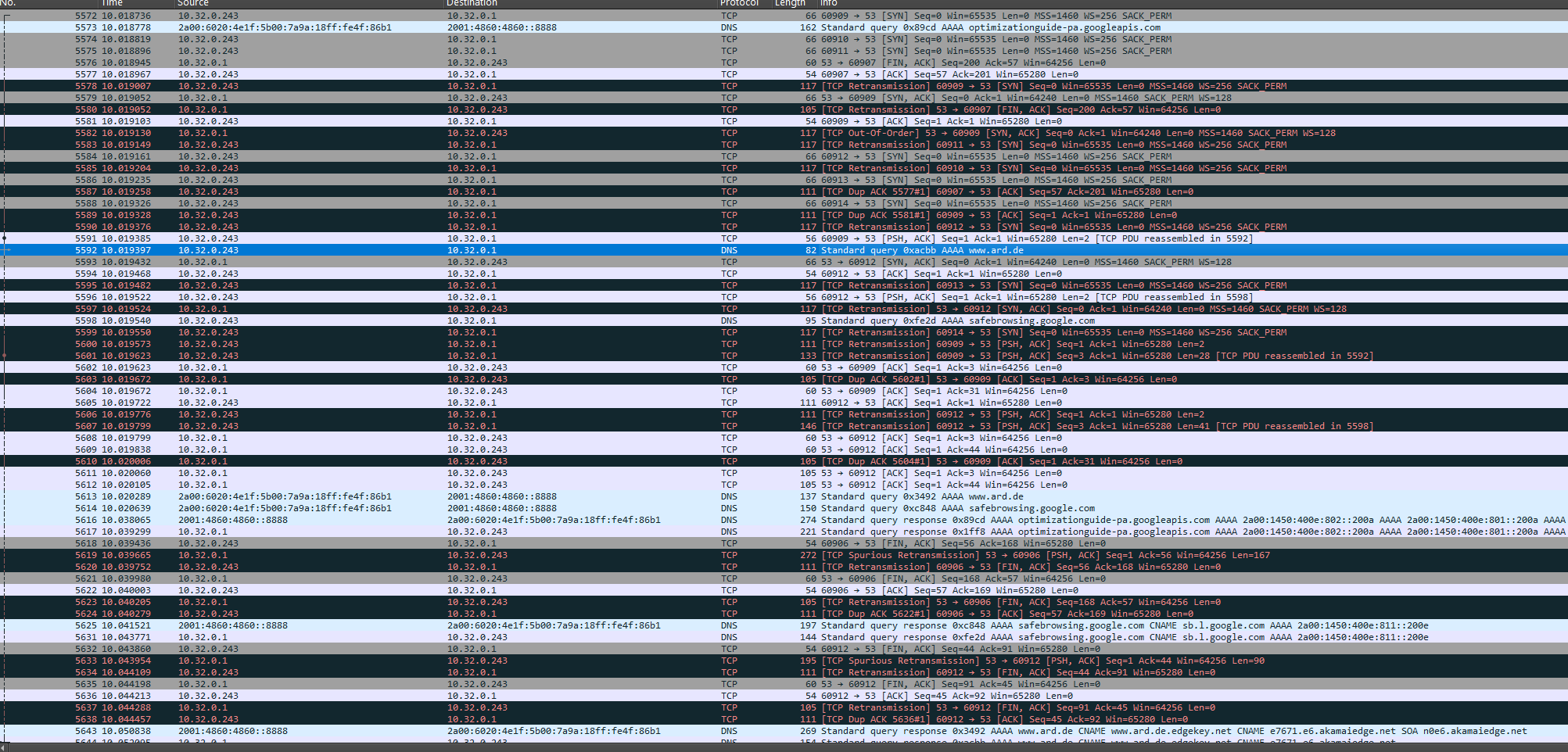

I did some deeper analysis of the problem using Wireshark on both the client and the RB5009.
Client IP: 10.32.0.243
RB5009 IP: 10.32.0.1
Request: AAAA www.ard.de
Wireshark on client:

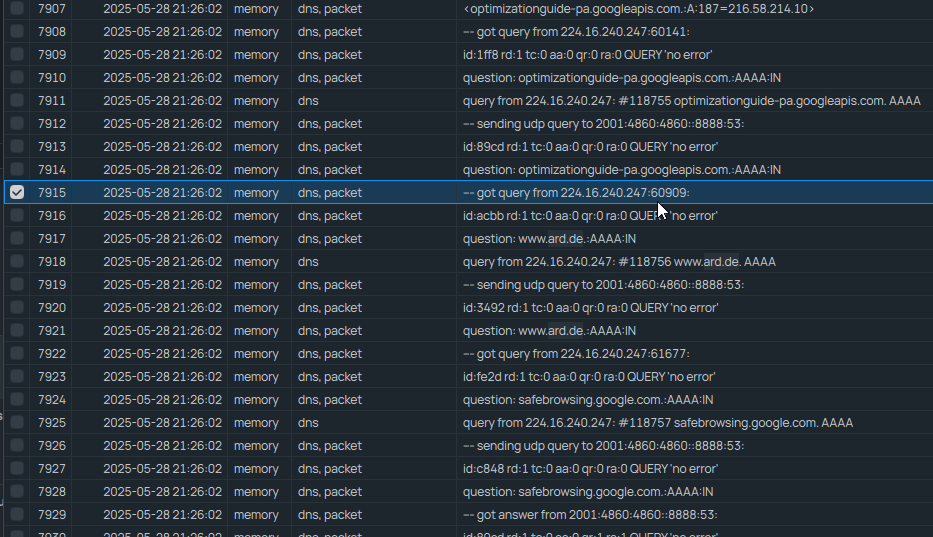

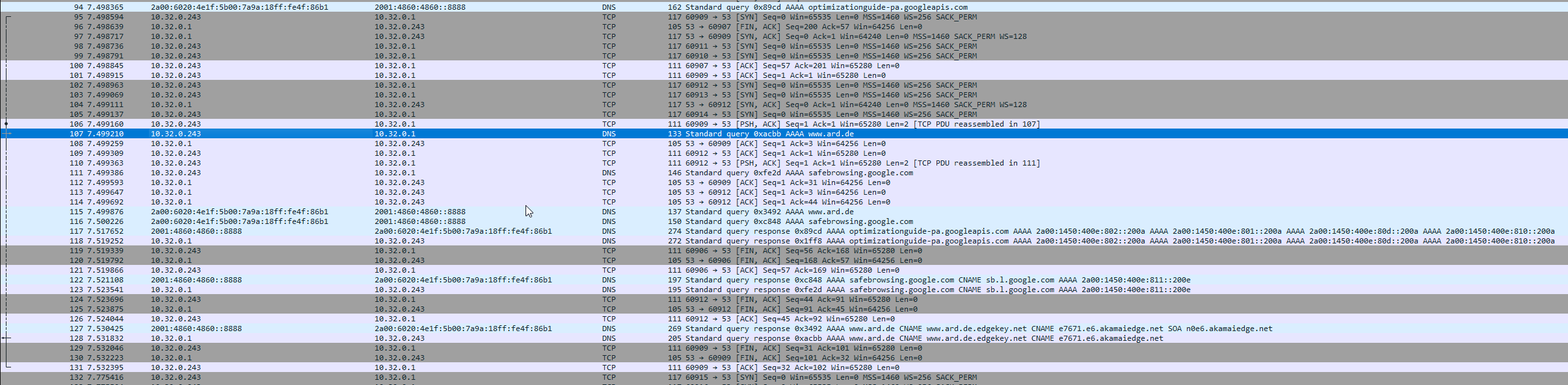

Wireshark on RB5009, there a lot of tcp retransmissions?
I also noticed that the sending IP address in the dns logs for TCP packages is wrong?
