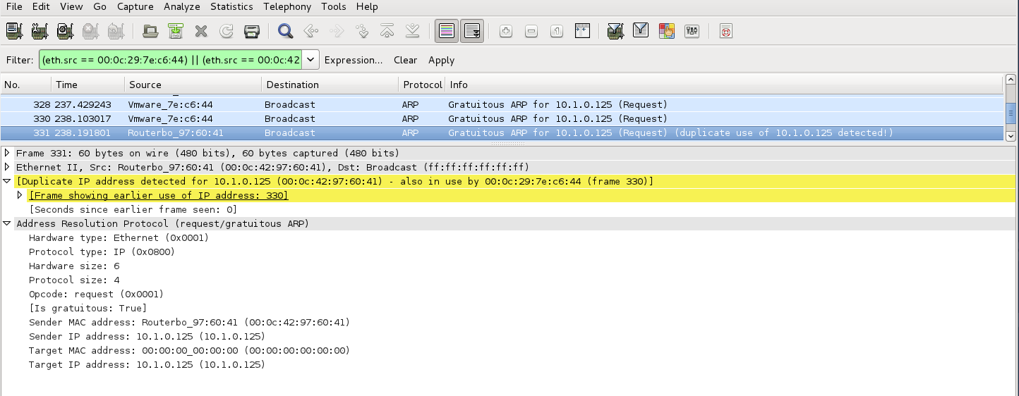

There is also a device connected to the LAN, with IP address 10.1.0.22 ( Running 2 IP networks on the same Ethernet broadcast domain - no VLANS)
If I add a 10.1.0.X/24 address to a PC on the LAN, I receive a duplicate IP address error.
Wireshark shows the router replying to the gratuitous arp request. If I add any 10.x.x.x address, it fails with the duplicate address detected message.
Why is the router replying to the gratuitous arp requests for all 10.x.x.x addresses?

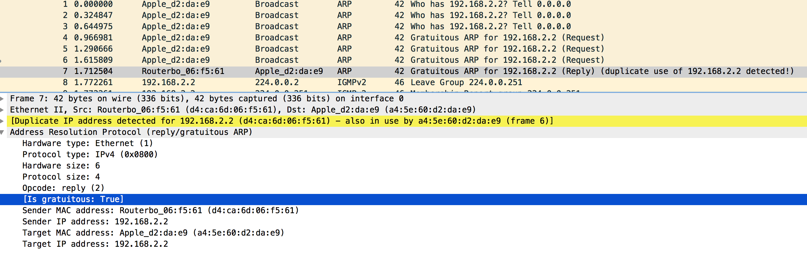

Hey,
I have the same issue with my mac book pro and 962UiGS-5HacT2HnT
Every time I connect to the network and have a secondary WiFi interface defined I receive this error on my mac that another system on the network is using this ip address - of course no one does.
I see the same picture as you do
